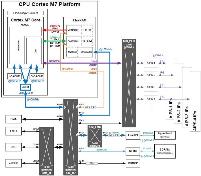

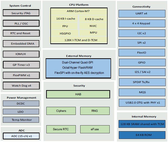

imxrt1010 system block diagram

jh0
In device datasheet I only see simplified bock diagram...
and nothing in reference manual. Searching over internet, I found only APF-SMC-T3273 with...
Does somewhere exits device (imxrt1010) full block diagram?
JH

EdwinHz
Hi @jh0,
A full block diagram for the RT1010 and all of its subsystems would be too big to handle, which is why the Reference Manual divides the block diagrams for each subsection. For example, "Figure 14-1. Block Diagram" shows the block diagram for the clocking side of the MCU, while "Figure 13-4. SOC Power Tree" shows the block diagram for the power tree of the MCU. You can look for keyword "Block Diagram" on the RM and you will find many diagrams, each for a respective subsystem of the RT1010.
BR,
Edwin.
