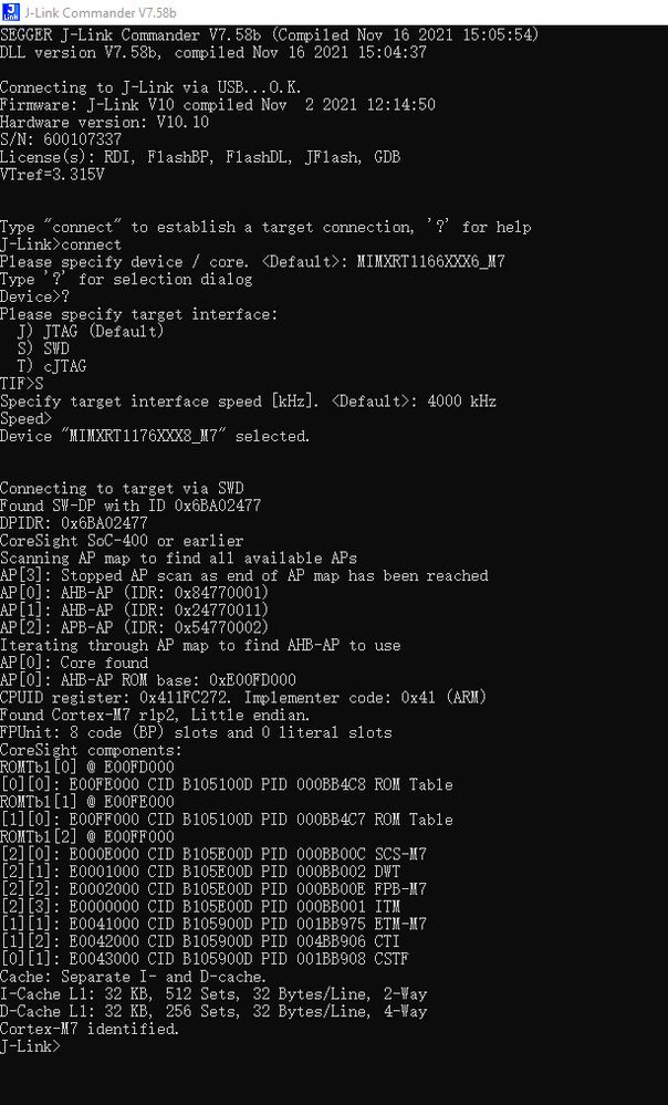

kerryzhou
Hi @ancymuhammed ,
   Do you have the JLINK?
   Use the JLINK command, to check whether you can find the ARM core or not?
  If you even can't find the ARM core, it means, these two boards have hardware issues.
   I mean JLINK test result like this:
Kerry
