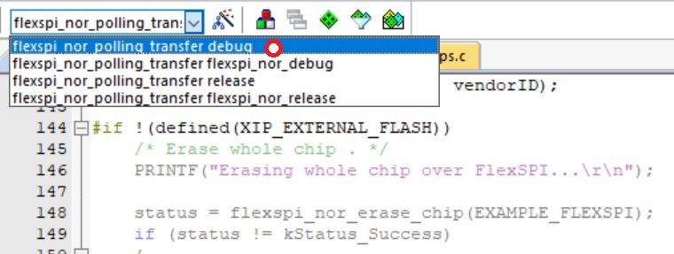

Dear NXP Team,
I'm going to try put code running on RAM (not in external SPI) in Keil project,
but seem something Keil setting problem and unable build success.
Could you provide some example or teach me how to configure Keil setting?

Thanks for your reply.
Sorry, I forgot to attach the file, so please check it now.
And you can learn more details by open the demo projects in the SDK library

george_phang
Thanks your reply soon, I will test it right now.
So when I select to debug project, is that no need to download, just press start debug session?

jeremyzhou
1) Is that no need to download, just press start to debug session?
-- Yes.

george_phang
Hi Jeremyzhou,
 Thanks you so much.
It's work.

jeremyzhou
1) Could you provide some examples or teach me how to configure Keil setting?
-- Per the attachment, you can choose the flexspi_nor_polling_transfer_debug option to put code running on RAM.

george_phang
 R1. Per the attachment, you can choose the flexspi_nor_polling_transfer_debug option to put code running on RAM.
- I still not understand what I do in Keil project "flexspi_nor_polling_transfer"'s debug option.
