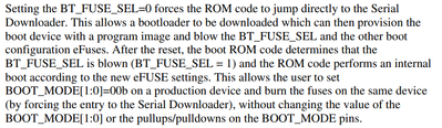

Thank you for your response, I've checked the documents that you've mentinoned in your answer and I am a little bit confused about the fuses and GPIO overrides.
  • For the case of fuses, once our custom board is ready, without any program embedded, can we burn fuses via uart by using MCU Boot Utility?
  • For the mass production, if we let Boot_Mode[1:0]=00b GPIO overrides will be ignored and mcu has no program inside at first, it will directly pass to serial download mode, before this happens can we set eFuses via MCU boot utility and set the qspi flash as the boot device. Then flash it, according to the RM this will set the BT_FUSE_SEL=1, which will lead to SMBR bits controlled by eFuse settings which we already configured before. So There is no need for boot config GPIOs hence we don't have to multiplex them with display GPIOs. As a result, no need to use bus isolation resistors? This kind of difference I think can be seen between the SLN-TLHMI- IOT board design which only has a QSPI flash, unlike the EVK board which has lots of flash devices available in the design.
  • Can we only use UART or USB for flashing the QSPI Flash?
Thank you in advance! Best Regards
