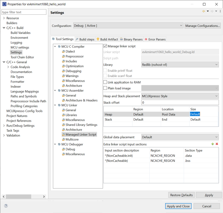

jingpan
Hi @yf2 ,
You can set heap size at here, by right click the project and select Properties.
Jing
5,527件の閲覧回数
yf2
@jingpan
Thanks for sharing the screenshot, but I am not using the MCUXpresso IDE.
I simply used $SDK/tools/cmake_tool_chain_files/ to build my program. It seems that the heap/stack sizes in the generated .elf file are very small but at runtime in main() the effective stack and heap sizes are much bigger as I can malloc() 16KB blocks and I can define 12KB stack variables.
I am just wondering where the magic happens?
