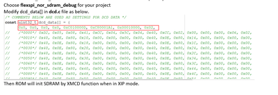

Hello community.
My customer try to build boot image.
In the process, we are investigating XMCD.
Is there a sample program that uses XMCD as described in 10.8 of the reference manual?
I look forward to hearing from you.
Ishii.

Hi @takayuki_ishii ,
   I have an example use the XMCD function to init SDRAM, please check the following code for IAR version.
Wish it helps you!
Kerry

Hello @kerryzhou
Sorry my miss reply.
I understand that I must change my dcd_data[] in dcd.c like this parameter.
I will try to modify and test it in my project.
Ishii.
