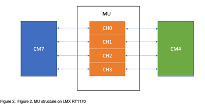

The RT1176 is a dual-core processor. By default, CM7 is the primary core and CM4 is the slave core. If you need to change the primary core to CM4, you need to flash eFuse.

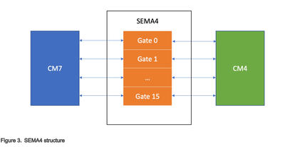

In dual-core applications, there are three main methods to keep the two cores in sync.
1.MU(Message Unit)
2.SEMA(Semaphore)
3.Shared memory
For detail description please refer to the link below
https://www.nxp.com.cn/docs/en/application-note/AN13264.pdf

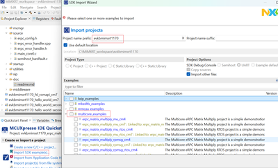

And also, you can import SDK demo to help you better understand.

Hello @Jeevan,
The SDK from NXP contains many examples. You can download it from https://mcuxpresso.nxp.com/en. Alternatively, it is also available at github (https://github.com/nxp-mcuxpresso/mcux-sdk), but with fewer examples.
Among other things, you can find examples for the MessagingUnit under 'boards\evkmimxrt1170\driver_examples\mu'
Alternatively, you can take a look at my Coremark example: https://github.com/Masmiseim36/Coremark_iMXRT
