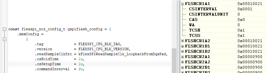

Senior Contributor I
if I specify a command interval in my XIP device configuration block the CSINTERVALUNIT bit in flash register FLSHCR1A1 will not be set to the value I specified.
Why does the Boot-ROM not set the value I specify? Does it not support this?

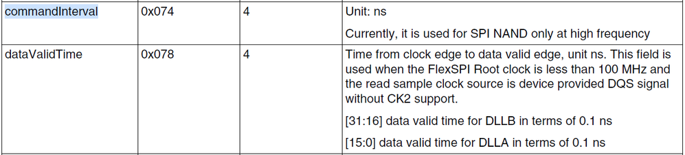

The commandInterval is only used to configure the SPI NAND currently as aforementioned.
In addition, the CSINTERVAL is used to set the minimum interval between flash device Chip selection deassertion and flash
device Chip selection assertion, and we can find that it's nothing along with the command interval actually.

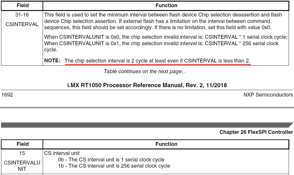

jeremyzhou
Hi Stefan Mitterhauser ,
1) Why does the Boot-ROM not set the value I specify? Does it not support this?
-- According to the below figure, the interval would be 2 cycles actually which is consistent with the configuration in qspiflash_config struct.

imxrtuser
Hi jeremy,
you are right. In this case it does not matter.
I tested it with the flexspi_nor_polling_transfer example project for RT1020 and set the value to
.commandInterval  = 8u,
but the register value CSINTERVALUNIT does not get set to 8.

jeremyzhou
Sorry for reply late.
After reviewing the RM, I find that commandInterval is invalid for Serial (SPI) NOR actually, currently, it is used for SPI NAND only at high frequency.
