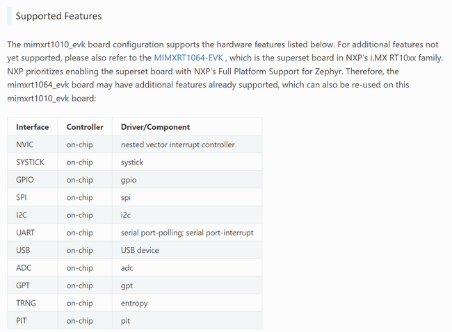

When starting a new project for a iMXRT1010 or iMXRT1064 board which IDE is best for a newbie?
Is this MCUXpress or VSCode (with MCUXpress for VSCode extension).
Or are they the same? I tried to find this out for a while now, but still am not sure.
Is it true that MCUXpress for VSCode is based on Zephyr?
Is Zephyr easier to learn for a newbie?
Are peripherals better supported in MCUXpress compared to Zephyr?
I do not mind learning a new environment. But I do not want to find out after hours of learning that I need to learn a different one.

Are peripherals better supported in MCUXpresso compared to Zephyr? A simple answer is yes. but let me provide details. First to check Zephyr support for your board ( Zephyr targets boards and then specific SOCs). For example lets browse the RT1010 page https://docs.zephyrproject.org/latest/boards/nxp/mimxrt1010_evk/doc/index.html
diego_charles_1-1731099218121.pngAs you can see, at this time, not all the peripherals are supported for the RT1010. When we say that a peripheral is supported is because the Zephyr RTOS HAL layers let you to use those peripherals with ease without having to worry about their low-level implementation, as you would do directly using our SDK drivers.
The SDK provides support for all the RT1010 peripherals, and the MCUXpresso IDE integrates build in our MCUXpresso Config Tools. The config tools can be used to create initialization code for peripherals, clocks, and pins. You may use the config tools to generate code when using Zephyr, but what is the point to init LPUART if the Zephyr RTOS already lets you do this?
