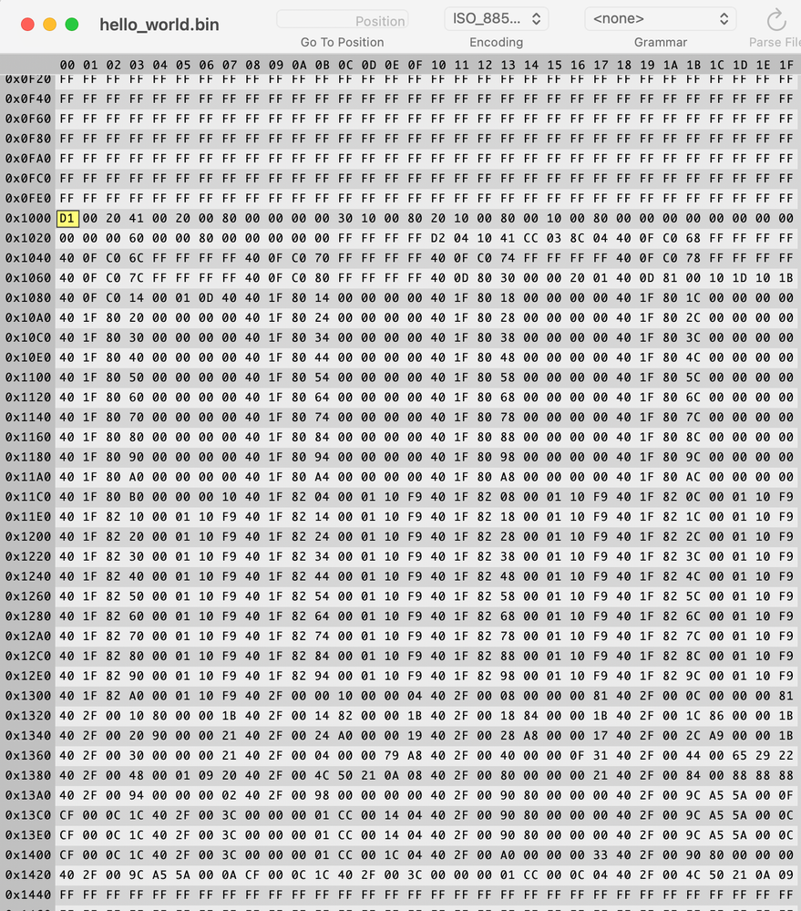

I am building some testing utilities for production.  I just need to load and run the testing utility once.   I am currently using a modified version of the NXP bootloader project, but that runs from DTCM and I am running out of space.
I would like to load the testing binary into SDRAM and run from there if possible.
I have created a python script to configure clocks and SDRAM, then load the binary into SDRAM and jump to SDRAM to begin execution, but the execution fails.
I have confirmed that I can read/write SDRAM using sdphost, so I'm not sure if the problem is with my linker, elftosb or if it just isn't possible to jump to an SDRAM address for execution.
Has anyone successfully done this?
I plan to just build a simple "hello world" executable and see if I can successfully load and run that as my next step, but was hoping someone has some insight.
thanks

Here are the sdphost commands I am executing:
Configuring system clocks...
Executing clock config command: ../secure_provisioning/tools/mac/sdphost -u 0x1FC9,0x0135 write-register 0x400fc068 32 0xFFFFFFFF
Executing clock config command: ../secure_provisioning/tools/mac/sdphost -u 0x1FC9,0x0135 write-register 0x400fc06c 32 0xFFFFFFFF
Executing clock config command: ../secure_provisioning/tools/mac/sdphost -u 0x1FC9,0x0135 write-register 0x400fc070 32 0xFFFFFFFF
Executing clock config command: ../secure_provisioning/tools/mac/sdphost -u 0x1FC9,0x0135 write-register 0x400fc074 32 0xFFFFFFFF
Executing clock config command: ../secure_provisioning/tools/mac/sdphost -u 0x1FC9,0x0135 write-register 0x400fc078 32 0xFFFFFFFF
Executing clock config command: ../secure_provisioning/tools/mac/sdphost -u 0x1FC9,0x0135 write-register 0x400fc07c 32 0xFFFFFFFF
Executing clock config command: ../secure_provisioning/tools/mac/sdphost -u 0x1FC9,0x0135 write-register 0x400fc080 32 0xFFFFFFFF
Executing clock config command: ../secure_provisioning/tools/mac/sdphost -u 0x1FC9,0x0135 write-register 0x400D8030 32 0x00002001
Executing clock config command: ../secure_provisioning/tools/mac/sdphost -u 0x1FC9,0x0135 write-register 0x400D8100 32 0x001D0000
Executing clock config command: ../secure_provisioning/tools/mac/sdphost -u 0x1FC9,0x0135 write-register 0x400FC014 32 0x00010D40
Configuring SDRAM registers...
Executing command: ../secure_provisioning/tools/mac/sdphost -u 0x1FC9,0x0135 write-register 0x401f8014 32 0x00000000

Here is an example "hello_world.bin" I am trying to load and run (for testing purposes).
I don't think the DCD information matters if loading directly from sdphost and jumping to execute (?)
1,232件の閲覧回数
jackking
Senior Contributor I
The IVT location seems correct at 0x1000
