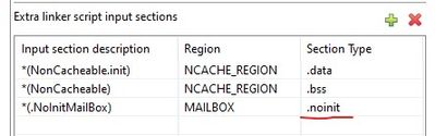

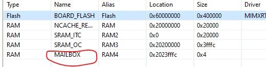

I’m trying to set a specific address in RAM to a value so on a reset the boot loader can read it and action on it. The RAM is configured to not initialise.
I've simplified the test so that it doesn't involve the boot loader and checks itself. My app sets the address to a value, resets and when it re-starts it simply prints out that value before it is set again.
Unfortunately the value is not as expected. Oddly if I step through the code and monitor the variable and RAM it works.
I'm using Embedded Artist's iMX RT1062 OEM board with NXP's MCUXpresso IDE and SDK.
I've added the variable to OC RAM using Properties C/C++ Build - MCU settings:
I also did this, but not sure it is required:
Variable declared as:
__NOINIT(RAM4) volatile unsigned long mailBox;        // note must be global!

I think that the value does not write back from DCache to ram before re-reset, so maybe you can clean the DCache before you re-reset the system. Or just place the SCB_CleanDCache() before you exit the code. Or you can try to place the value in a non-cache area, such as DTCM

Note that the RAM type used for the mailbox location depends on the FlexRAM configuration that the application uses. It is defined in the uTasker loader to be at the top of FlexRAM bank 15 (of 1062) so that it is sure that the ROM LOADER doesn't use the space (and also to enable on-the-fly FlexRAM changes without stack corruption). The exact layout and details are in chapter "RAM and Cache" of https://www.utasker.com/docs/iMX/i.MX_RT_1060_uTasker.pdf
The uTasker application is optimised for speed and so this is in fact always in DTMC when the application runs.
In environments that happen to have this in cached OCRAM disabling the data cache when writing is suitable solution since the next event is a reset anyway.
