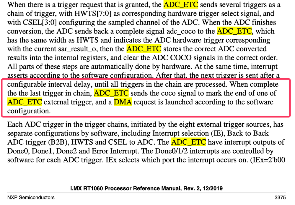

I am looking at using ADC_ETC and DMA together on iMXRT1062.  I see the SDK sample project (adc_etc_edma) which does transfer the ADC results using DMA successfully.
But, I also see that there is a call to EDMA_StartTransfer(&edmaHandle) after the EDMA callback sets a flag.  According to the i.MX RT1060 Reference Manual Rev. 2 (page 3375), this should not be necessary, as the ADC_ETC completion should trigger a new DMA transfer directly.  The ADC_ETC trigger chain is being triggered by the PIT, so this should allow the ADC_ETC->DMA transfer to run completely through DMA repeatedly.
I tried removing the StartTransfer call from the example, but the ADC_ETC does not seem to trigger a new DMA transfer.  Is there some other setting that is required for the ADC_ETC to initiate a new DMA transfer?

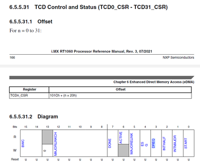

TCD0_CSR[DREQ] is set to 1 in the EDMA driver. The request is disabled after each major loop ends, so it needs to be re-enabled.
Wish it helps you.
MayLiu

I checked the i.MX RT1060 Reference Manual Rev. 3 page3451,  it seems different from the version 2.

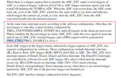

I can not see all your code in the post. But I think you can check that  whether the  register DMA_CTRL[TIRGa_ENABLE]set to 1  when complete the the last trigger in chain in your project.

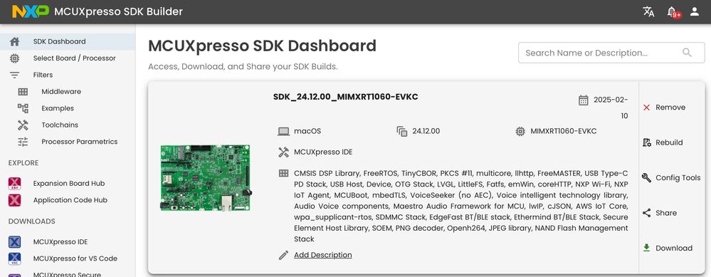

I think you are looking at an old SDK version…
This version of the SDK does have an example for adc_etc_edma.  The sample does enable DMA triggering for the ADC_ETC, using ADC_ETC_EnableDMA()

Yes,  I can import adc_etc_edma demo after update my SDK version 24.12.00.

And the Reference Manual entry which suggests this should not be necessary:
1,946 Views

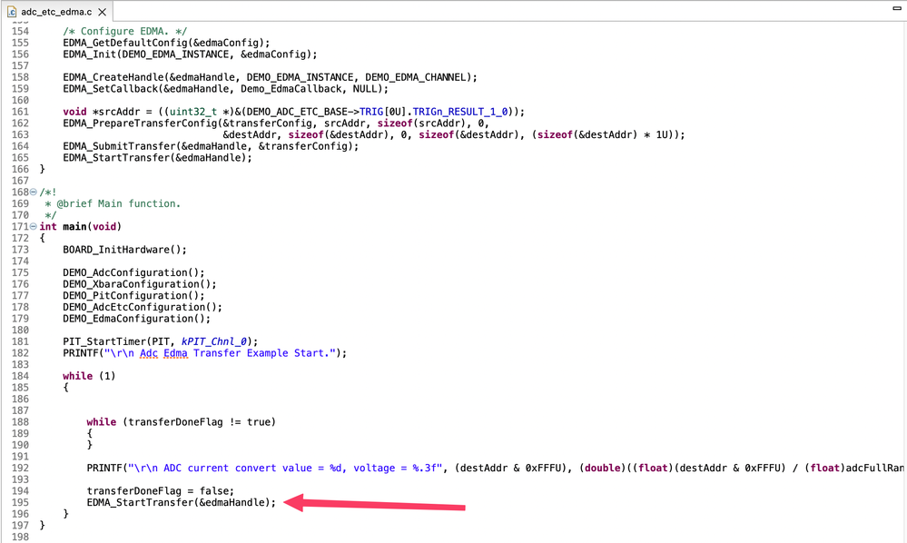

Senior Contributor I
This is the line in the SDK example I am referring to:
