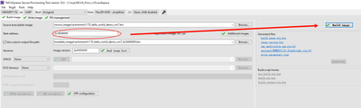

Please refer to this document, which mentions, MCUXpresso's link script generation mechanism:
Therefore, this is an expected issue.
For your application scenario, we suggest you to verify the default flash start address first, and after verification, you can burn image in serial download mode by "MCUXpresso Secure Provisioning Tool".
Gavin_Jia_1-1739779514824.pngGavin_Jia_1-1739779514824.pngGavin_Jia_2-1739779533157.pngGavin_Jia_2-1739779533157.png

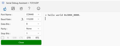

Also, Here I have attached my linker file, which is not part the abovementioned process. This (refer image) is what happens when I debug. Modified the memory address in MCU Settings and unchecked the Mange linker script option and added boot_hdr part manually.
Please check why it is not coming to the main function
