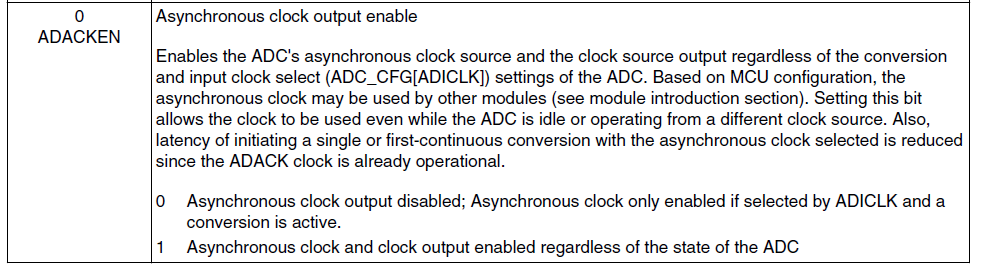

Hovering above this check box tells me that checking it will optimize ADC start up time, but how much faster will it be if I enable it?
The reference manual states
, but it does not tell me how much faster it will be?

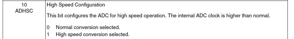

How much higher is the ADC clock? The "normal" frequency is 10 MHz correct?

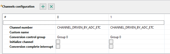

I want all channels of the ADCs to be controlled by ADC-ETC, but if I add more than one channel with the channel number to "CHANNEL_DRIVEN_BY_ADC_ETC" I get a warning that there are some duplicated ADC channels in the configuration. Do I have to set every channel with "CHANNEL_DRIVEN_BY_ADC_ETC" or just leave the "Channels configuration" empty?

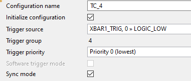

The Trigger group depends on the selected Trigger source. If I hover above the Sync mode checkbox I can see that there are couples wich can be triggered from the same trigger.
I set up Trigger group 0 and now I want to also Trigger group 4 in sync to it. For that I have to set up a new XBARA Trigger configuration where I choose XBAR1_TRIG,0 as Trigger source and I set the Sync mode.
In the Trigger source field there is the entry "0 >> LOGIC_LOW" which suggests that the trigger is connected to GND. Do I have to be concerned about that or does it not matter?

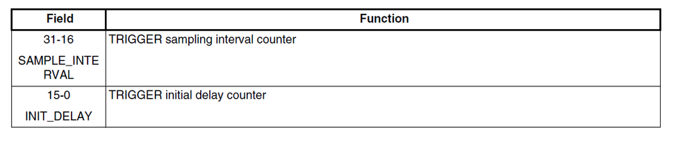

The boxes "Desired initial delay" and "Desired interval delay"
have to be set to at least 1 tick. The reference manual entry to ETC_TRIG0 Counter Register does not mention that the counter has to be set at least to 1 tick.
Is it necessary to set it to 1 or is it allowed to be zero?

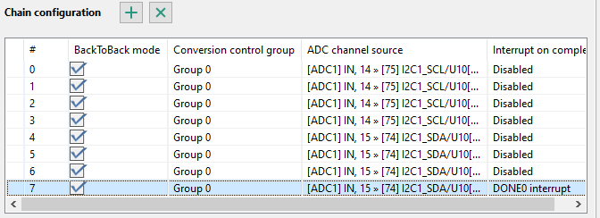

I want to measure the same input 8 times and at the end the DONE0 interrupt should be fired. I set the Chain configuration to
And after triggering once it will do chain 0, after chain 0 finished it will automatically do chain 1, then chain 2.... correct?
Will the data be stored in TRIG0_RESULT_1_0 DATA0 to TRIG0_RESULT_7_6 DATA7 or will every chain write the result of the measurement to TRIG0_RESULT_1_0 DATA0 because I selected "Conversion control group Group 0" for every chain?

1) When you have selected Asynchronous Clock as the clock source and then check the checkbox "Start asynchronous clock output", you are able to see the change in the "Resulting conversion time" info item below the "Conversion" configuration structure (above "Result correction" configuration structure).
2) When you want to run the ADC at the highest speed so you can choose some other clock source like you say.
And you can find information about ranges in the datasheet in chapter "Electrical characteristics" -> "Analog" -> "A/D converter". Screenshots below are taken from https://www.nxp.com/docs/en/data-sheet/IMXRT1050CEC.pdf
As you can see typical value of Asynchronous clock in high speed is 20 MHz, other clock source ranges are in the table first table.
3) You're right the combination of bitfields ADHSC = 1 and ADLPC =1 is nonsense, so it is not in the datasheet also as you can see in the first table above.
7) OK, "Desired initial delay" value can be 0.
But for the Interval it doesn't make sense to start next conversion in chain without delay, it can only abort previous undone conversion or leads into the error interrupt.

1 Hovering above this checkbox tells me that checking it will optimize ADC startup time, but how much faster will it be if I enable it?
-- The Asynchronous clock is selected as the clock source of the ADC will optime ADC start time, it's nothing related to the ADACKEN setting.
2. The High-Speed configuration allows the ADC can work with the higher clock.

5) These warnings just remind you to select the ADC sample channel prudently to avoid select duplicated ADC channels

1) The checkbox "Start asynchronous clock output" will be stored in the ADC1_config structure
.enableAsynchronousClockOutput = true,
which will be set in the function ADC_Init
 if (config->enableAsynchronousClockOutput)
        tmp32 |= ADC_GC_ADACKEN_MASK;
so this option sets the ADACKEN bit in the register.
How does the peripheral optimize start up time and how much faster will it be?
So I have to provide the higher clock myself with IPG_CLK_ROOT? What is the minimum frequency where I have to activate the High-Speed configuration for proper work?

7) Is it necessary to set it to 1 or is it allowed to be zero?
-- It allows being zero actually.

1) How does the peripheral optimize startup time and how much faster will it be?
-- Please check the below figure.

5) Do I have to be concerned about that or does it not matter?
-- The trigger source means the external triggers from the XBAR module.
8) Data be stored in TRIG0_RESULT_1_0 DATA0 to TRIG0_RESULT_7_6 DATA7
