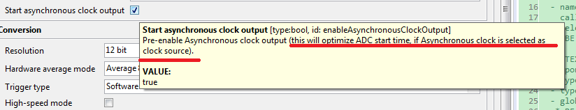

Hovering above this check box tells me that checking it will optimize ADC start up time, but how much faster will it be if I enable it?
The reference manual states
, but it does not tell me how much faster it will be?

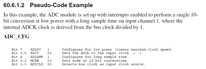

About the low power mode the pseudo-code example (60.6.1.2) states in a comment that the low power mode lowers the maximum clock speed. Does it more? To which frequency does it lower the clock speed? If this one lowers the clock speed then selecting "high speed" and "low power" makes no sense right?

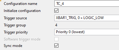

The Trigger group depends on the selected Trigger source. If I hover above the Sync mode checkbox I can see that there are couples wich can be triggered from the same trigger.
I set up Trigger group 0 and now I want to also Trigger group 4 in sync to it. For that I have to set up a new XBARA Trigger configuration where I choose XBAR1_TRIG,0 as Trigger source and I set the Sync mode.
In the Trigger source field there is the entry "0 >> LOGIC_LOW" which suggests that the trigger is connected to GND. Do I have to be concerned about that or does it not matter?

1) When you have selected Asynchronous Clock as the clock source and then check the checkbox "Start asynchronous clock output", you are able to see the change in the "Resulting conversion time" info item below the "Conversion" configuration structure (above "Result correction" configuration structure).

1 Hovering above this checkbox tells me that checking it will optimize ADC startup time, but how much faster will it be if I enable it?
-- The Asynchronous clock is selected as the clock source of the ADC will optime ADC start time, it's nothing related to the ADACKEN setting.

1) The checkbox "Start asynchronous clock output" will be stored in the ADC1_config structure
.enableAsynchronousClockOutput = true,
which will be set in the function ADC_Init
 if (config->enableAsynchronousClockOutput)
        tmp32 |= ADC_GC_ADACKEN_MASK;
so this option sets the ADACKEN bit in the register.
How does the peripheral optimize start up time and how much faster will it be?

3) I've not found the pseudo-code example code in the RM of RT1050, whether you can attach the codes here.
Here the code example:

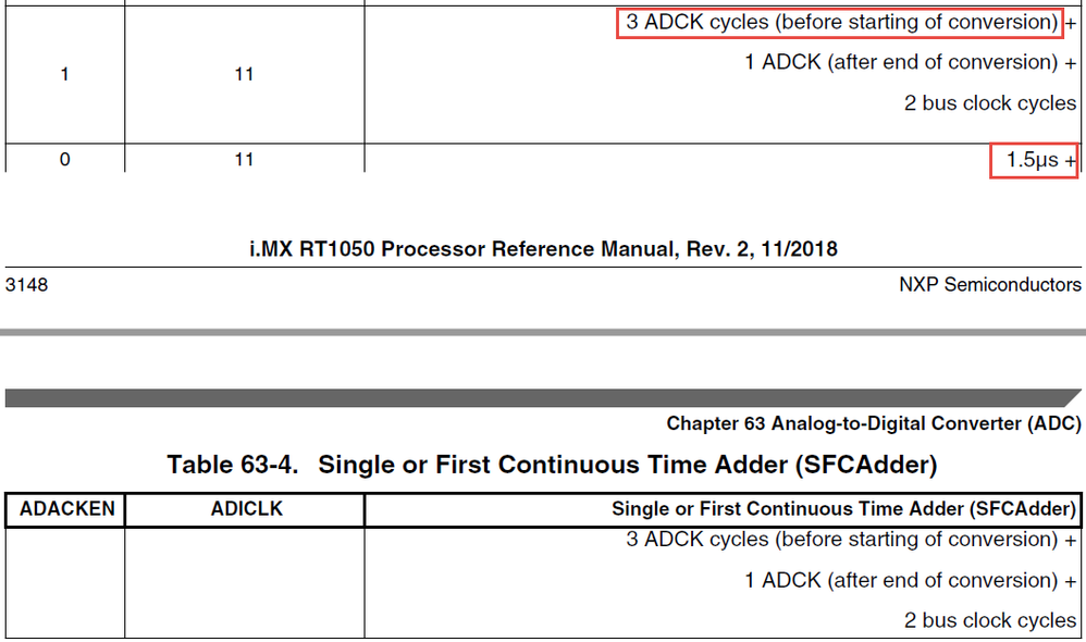

1) How does the peripheral optimize startup time and how much faster will it be?
-- Please check the below figure.
2) I think Jiri Chvatik already gived a detail clarification for question 2 & 3.

5) Do I have to be concerned about that or does it not matter?
-- The trigger source means the external triggers from the XBAR module.
