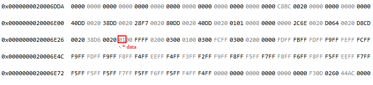

I'm confused about the operation of the USB Host Audio APIs and was hoping someone may be able to clarify a few questions.
My RT1050 is setup as a USB Audio Host. I'm able to receive audio data from a connected device by repeatedly calling USB_HostAudioStreamRecv. However, the dataLength parameter returned in the _HostAudioInCallback function is different from what I was expecting.
Each time the _HostAudioInCallback is called, the dataLength parameter is set to 128 bytes, despite the audioBuffer passed into the USB_HostAudioStreamRecv function being 2048 bytes.
However, looking at the memory location of the audioBuffer, it looks like 2048 bytes of data are written between each call to _HostAudioInCallback.
Is anyone able to explain this behavior?

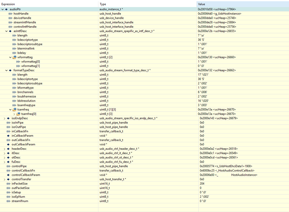

amwilhite
Jorge,
I did as you suggested and found the maxPacketSize to be 204 bytes, and then set the AUDIO_BUFFER_SIZE variable to 204.
Now, each call to _HostAudioInCallback returns a dataLength of 12 bytes.
Although the 12 bytes is at least divisible by the 6 channels, it's still not the 192 bytes I was expecting.
I've attached an image of the audioPtr's values as seen with the debugger in the _USB_HostAudioOpenInterface function.
I've confirmed the number of channels, bit resolution, and sampling frequency with the values in the structure.
Do you have any insight into why the dataLength is now 12 bytes rather than 192?

jorge_a_vazquez
Hi Austin Wilhite
At what speed are you requesting data? if you decrease the time between each USB_HostAudioStreamRecv? Do you still get 12 bytes?
Please remember that the 204 size that you get is the max capacity that your device can give, but it doesn't mean that it will give you the 204. In an isochronous communication, the bandwidth has to be guaranteed, but if the device is not ready to provide the information, it will be less than the max packate size (204 in your case).

In the _HostAudioInCallback, dataLength is still being set to 12. However, looking at the received data buffer in memory, I see that the RT1050 actually did receive all 88 bytes of the packet that I saw in the trace of the bus.
Here's the trace that shows the 88-byte packet and an expanded view that shows the packet's data.
Here's the memory viewer window showing the receipt of all 88 bytes of data that was seen on the bus.
I there a configuration setting that can lead to this improper reporting of dataLength, or is there a flaw in the USB stack that is causing this issue?
