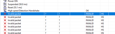

Hi Mark - Unfortunately still no joy.
I updated my application build to create a bootloadable image and it works AOK with the slow stick.
The fast stick goes into an infinite loop.
Here's what I did to try get the fast stick working:

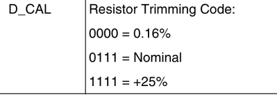

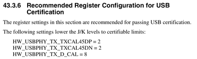

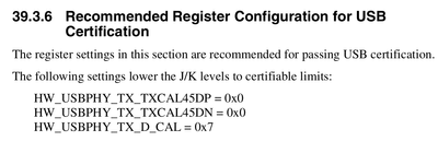

  2. USB power setting bug in uTasker USB stack corrected:
    1. "C:\uTasker-GIT-Kinetis\Hardware\Kinetis\kinetis_USB_HS_OTG.h"
      replace line 2121 with:
      phy->USBPHY_TX = (USBPHY_TX_EDGECTRL_VALUE | USBPHY_TX_RSVD1_VALUE | USBPHY_TX_TXCAL45DP_VALUE | // DRN: Correction per Mark Butcher
      USBPHY_TX_TXCAL45DN_VALUE | USBPHY_TX_DCAL_VALUE); // DRN: Correction per Mark Butcher
    2. When that did not work I tried the value 0x1006060c as that works in my application
The diagnostics (read from my in-memory buffer by connecting to the running bootloader):
No Application found in flash!!
USB HS device detected
USB device information ready:
USB2.0 device with 64 byte pipe
Vendor/Product = 0x0781/0x5588
Manufacturer =  \"SanDisk\"
Product = \"USB Extreme Pro\"
Serial Number = \"12A4567989D6\"
Self-powered device with  1 interface(s)
Mass Storage Class : Sub-class = 0x06 interface protocol = 0x50
Endpoints:
1 = BULK IN with size 512
2 = BULK OUT with size 512
Enumerated (1)\n\rLUN = 1
UFI INQUIRY -> Status transport - Passed
UFI REQUEST SENSE -> Status transport - Passed
UFI FORMAT CAP. -> H:1 0x02008140 0xf0406001 0x02008100
HS USB error - 0
Stall on IN EP-1
Cleared IN EP-1
Status transport - UFI FORMAT CAP. -> H:1 0x82008140 0xf0406001 0x82008100
HS USB error - 0
Stall on IN EP-1
Cleared IN EP-1
HS USB error - 0
Stall on IN EP-1
Cleared IN EP-1
Status transport - UFI READ CAP. -> (512:250085375) Status transport - Passed
Mem-Stick mounting...
*H:1 0x82008140 0xf0406001 0x82008100
HS USB error - 0
 TOD Timeout!
Stall on IN EP-1
Cleared IN EP-1
HS USB error - 0
Stall on IN EP-1
Cleared IN EP-1
HS USB error - 0
Stall on IN EP-1
Cleared IN EP-1
HS USB error - 0
Stall on IN EP-1
Cleared IN EP-1
HS USB error - 0
Stall on IN EP-1
Cleared IN EP-1
HS USB error - 0
Stall on IN EP-1
Cleared IN EP-1
HS USB error - 0
Stall on IN EP-1
Cleared IN EP-1
HS USB error - 0
Stall on IN EP-1
Cleared IN EP-1
HS USB error - 0
Stall on IN EP-1
Cleared IN EP-1
HS USB error - 0
Stall on IN EP-1
Cleared IN EP-1
HS USB error - 0
Stall on IN EP-1
Any ideas? What have I missed?

I received the drive and did a first quick measurement with my USB analyser and MIMXRT1024EVK running the MSD-host:
1. A typical HW device connection:
seen when connecting various devices (memory sticks, mobile phones, serial cables, wifi modules, etc.)
2. Connecting this stick (which otherwise behaves as you have described)
The high speed handshake is normal after the USB reset but when the host tries to send the getDescriptor (as is the case when a device is detected) the data that it sends out is "mangled".
Instead of the SETUP being seen [that is the byte sequence 0x2d 0x00 0x10] the analyser sees (when I check the data in the Invalid packets, which are being repeated by the USB controller due to a bus problem)
0xbd 0x95
0xbd 0x79 0xe8
0x7d 0x79 0xe8
0xbd 0x79
0xbd 0x79
0xbd 0x76 0xf4
and other similar but random values before giving up.
Therefore my initial impression is that the stick is loading the bus much more that expected and the data is not being sent (being corrupted) or its power consumption is causing the voltages to drop to unreliable levels.
Alternatively it may be that the stick drives the bus for a short time and this corrupts any data the host sends.
Could you check in the operating stack how it configures the HSUSB transceiver to see whether is does anything special (like setting very high drive level) or whether it adds a delay before it sends the first data [comparing the operation with a windows host I see that there is 30ms delay between the HW detection and the getDescriptor start]?

I experimented and identified how to get the stick working.
This is the line that is causing problems:
phy->USBPHY_TX = ((phy->USBPHY_TX & ~USBPHY_TX_DCAL_VALUE) | 0x0c); // trim the nominal 17.78mA current source for the high speed drivers (USB_DP and USB_DM) (taken from NXP reference)
 since it causes the value 0x1006060f to be written.
It works when I change the line to
phy->USBPHY_TX = ((phy->USBPHY_TX & ~USBPHY_TX_DCAL_MASK) | 0x0c);
which then sets 0x1006060c.
Although I never had an issue with any other device the D_CAL resistor trimming code value of 0xf (+25%)
doesn't allow bus operation with this particular stick.
Notice that I had an error in the code since the masking of the field was not correct since it was masking with 0xc instead of with 0xf but, as noted, this difficulty was never experienced with any other device and so was "hidden".
However, reading the user's manual in more detail I find this (for the MIMXRT1024):
which in fact 'recommends' the use of 0x10000007 and not 0x1006060c as used by the SDK and also your project code. Those values are, according to this, potentially not certifiable.
I then checked in the MIMXRT1060 user's manual and find that other values are recommended there:
Due to this I tried the recommended values on the MIMXRT1024EVK and they worked OK.
This means that I have changed my own code base to set the recommended values, depending on processor type:
