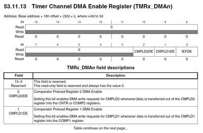

My reading of the reference manual is that the TMR should be able to generate DMA requests when CMPLD1 (or CMPLD2) "needs an update" (see Sec 53.10). I'm not totally sure what "needs an update" means, but according to Sec 53.11.13 it seems that it should mean anytime the the contents of CMPLD1 are transferred to COMP1
Setting this bit enables DMA write requests for CMPLD1 whenever data is transferred out of the CMPLD1 register into the COMP1 register.

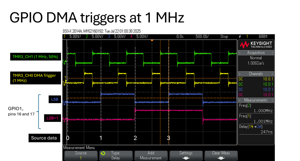

I've configured TMR3_CH0 to generate a 1 MHz signal with 25% duty factor, synchronous to TMR3_CH1 (50% duty factor).
Unfortunately, it appears that the GPIO writes are not synchronized to the TMR channels, as you can see in the following oscilloscope capture. I've configured the DMA source to buffer the values [0, 1, 2, 3] and the destination to be GPIO1->DR. These decimal values can be represented on the two pins (captured by CH3 and CH4 of the oscilloscope).
So the DMA transfers are happening, but they are not being triggered by TMR3_CH0 as desired.
Any ideas as to what might be wrong?

A summary screenshot is shown here:, showing parallel updates to GPIO1, pins 16 and 17, triggered by the COMP events on TMR3_CH0. The latency between the COMP2 event and an update of the GPIO lines is about 250 ns.

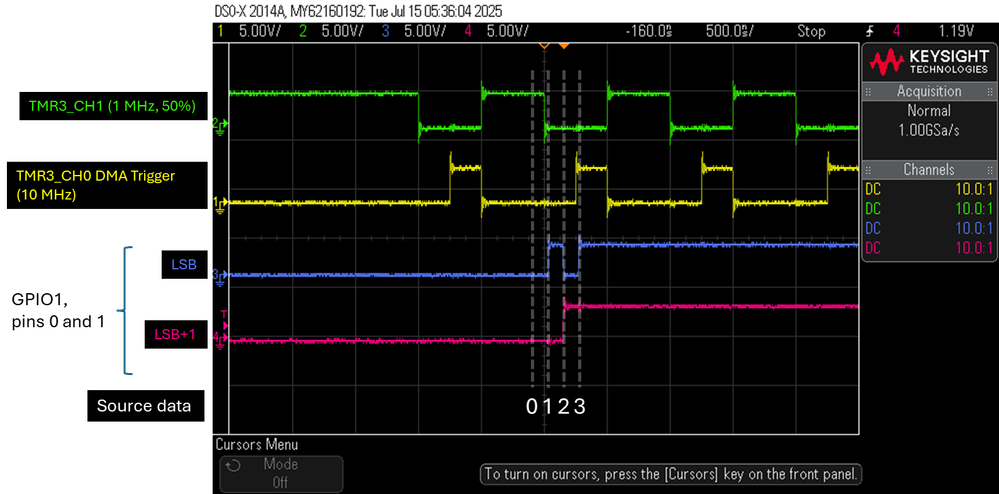

Unfortunately, with linked channels, it seems that the fastest I can trigger the GPIO writes is about 3 MHz. For example, if DAC_CLK_FREQ_HZ is set to 10 MHz, the GPIO writes no longer remain synchronized to the the TMR periods. It seems the fastest the GPIO lines can be updated is about 250 ns, or 38 cycles of the 150 MHz IPG_CLKC that runs the DMA and GPIO peripherals. Is 38 cycles consistent with execution of two linked DMA channels, one of which writes the 16-bit CMPLD register, and the second of which writes to the 32-bit GPIO DR register? That seems like a lot of extra cycles.
UDPATE: There isn't a section in the iMX reference manual on eDMA Performance. But by comparison to the K66 reference manual, it seems that ~17 cycles per eDMA request is expected (Table 24-5). This is consistent with the 38 cycles to process the two linked channel requests in my demo.
