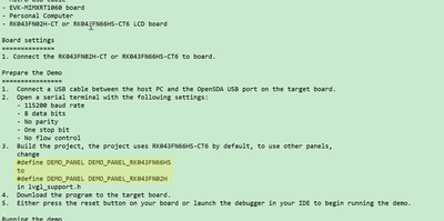

I am evaluating Gui Guider on RT1062 EVK with 4.3 display. I can download demo projects and see the main screen, but the touch panel is not working on any of the projects. I tried several others. It's the same issue. I used the liitlevgl_demo_widgets project from SDK to make sure the touch panel is fine. I can use a touch panel in that project, but not in any of Gui Guider projects. Any idea what is going on?

  Which Gui Guider demo you are using now? Your own created demo or the SDK demo?
  You need to make sure you are using the correct LCD definition:
And then, you need to check your used demo contains the touch function or not, as now, you already demonstrate your touch is working, just your GUI guider demo no touch works, so I am thinking, whether your used gui guider demo add the touch function or not?

Hi Kerry,
Yes, That's the problem. I changed Panel Type and now its responding to Touch events. Thanks for the resolution.
