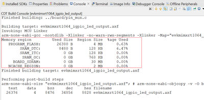

Hi, I'm using i.MX RT1064, and I need to calculate RAM and CPU usage. Is there any SDK example available to fetch the details or suggest the recommended method, Could you please help me in this?
NOTE : we are using malloc not vPortMalloc .

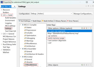

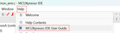

I suggest you can use MCUXPresso IDE. I suggest you can refer to User Guide for more detail information.
The memory regions displayed here match up to the memory banks displayed in the memory configuration editor when the managed linker script mechanism is being used.
in Heap and Stack Usage window, It shows Heap and Stack usage information.
