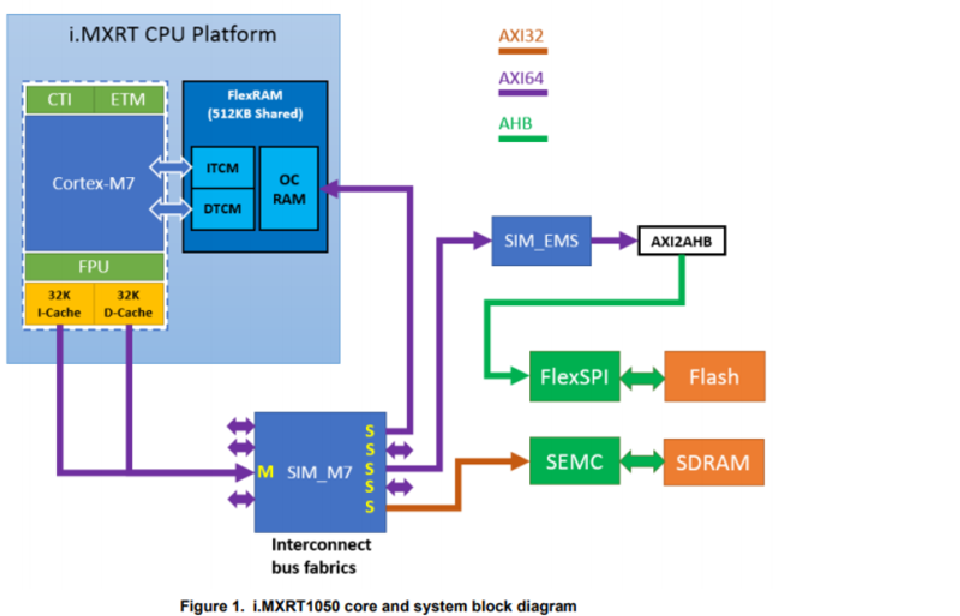

The i.MXRT series implement a CPU core platform described in Figure1. The L1 I/D-Cache is embedded in the core platform.
The data cache is 4-way set-associate and instruction cache is 2-way set-associate with cache line size of 32 bytes. It connects with the SIM_M7 bus fabric master port by AXI bus. The subsystem of internal/external memory like OCRAM(FlexRAM banks configured as OCRAM), FlexSPI (Serial NOR, NAND Flash and Hyper Flash/RAM etc) and SEMC(SDRAM, PNOR Flash, NAND Flash etc.) are connected to the bus fabric slave port. CPU core access the subsystem through this bus fabric by L1 cache. The ITCM/DTCM is accessed directly by CPU core, bypass the L1 cache.
OCRAM and SDRAM is cacheable by default.
The cache brings a great performance boost, but the user must pay attention to the cache maintenance for data coherency.  To avoid data coherency issue, the easiest way is to use non-cacheable buffers.
 DTCM/ITCM is Tightly-Coupled Memories, core can access it directly (cache is not involved). That can explain why all SDK demos work correctly by default.

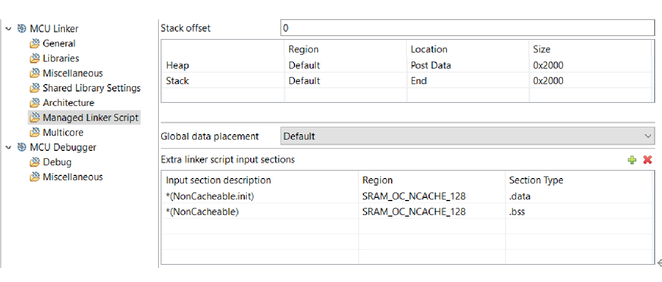

2    Linker file : partition a RAM block from OCRAM for non-cacheable buffers
Using managed linker script to configure memory RAM2 as a non-cacheable area.

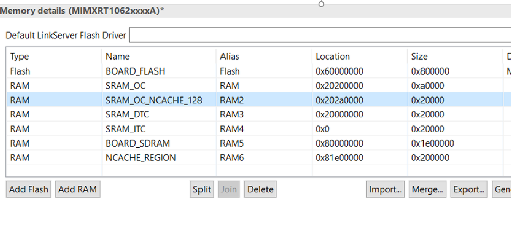

3    MPU configuratins   ( board.c )
 MPU divides the memory map into a few regions, and defines the memory attributes of each region.
In this step, we need to configure the SRAM_OC_NCACHE_128(RAM2) as non-cacheable
     /* Region 13 setting: Memory with  non-cacheable */
    MPU->RBAR = ARM_MPU_RBAR(13, 0x202a0000);
    MPU->RASR = ARM_MPU_RASR(0, ARM_MPU_AP_FULL, 1, 0, 0, 0, 0, ARM_MPU_REGION_SIZE_128KB);
Now, SRAM_OC_NCACHE_128 (RAM2) is a non-cacheable section.
Variables in  *(NonCacheable.init) and  *( NonCacheable) will be put to SRAM_OC_NCACHE_128.

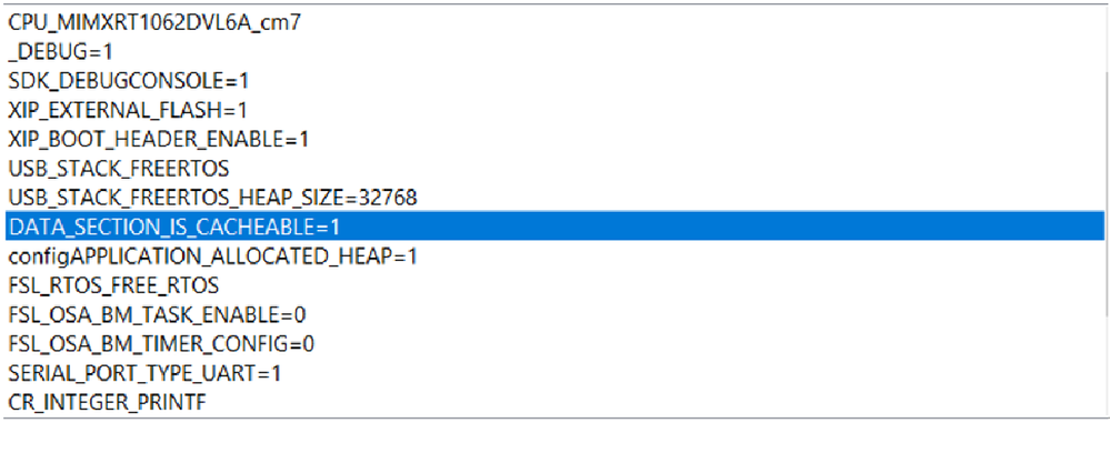

Please put macro “DATA_SECTION_IS_CACHEABLE=1” in the preprocessor define.

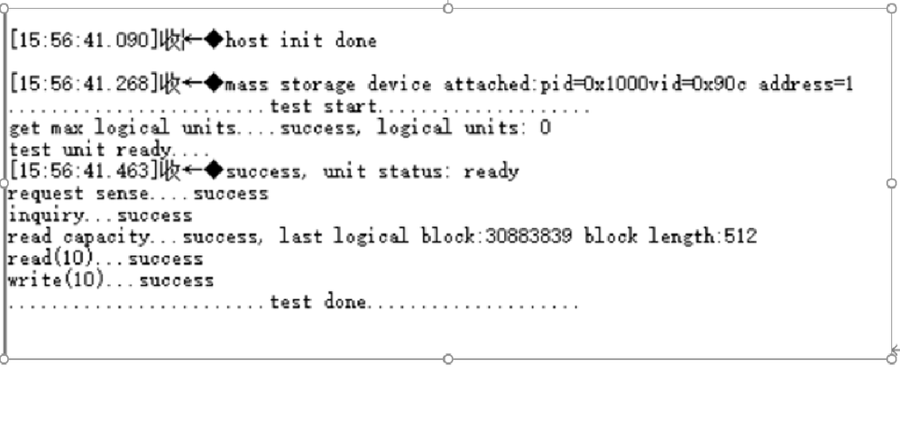

5    build and run project  evkmimxrt1060_host_msd_command_freertos, success!
