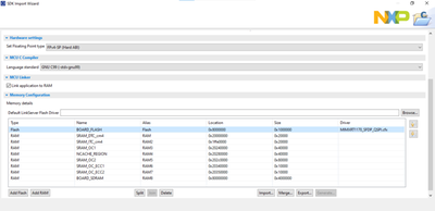

ManikantaRobbi
Hi @Masmiseim ,
Thanks for the information. I had followed the instructions for mem config. Image attached reflects the changes done in memory "0x30100000"  and the project created for CM4. But again I'm getting build failed.
This is log message after build.
So can't we create a new project for CM4 access the QSPI.
Manikanta Robbi.
3,394件の閲覧回数
Masmiseim
Senior Contributor I
Looks to me like a problem with the JTAG connection. Does a connect via J-Link Commander to the M4 core of the iMXRT1170 work?
