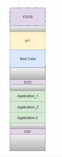

I'm working on enabling secure boot for IMXRT processor.
As per our design we have 3 boot images including our custom bootloader. I would like to implement the secure boot extending till the application image with the chain of trust through all three boot stage images.
Please answer the below queries in this regard.
1. If the SRK hash is fused, does the processor always try to authenticate the primary image being loaded, without any further configuration ? (Board in Open configuration)
2. To extend the chain of trust, I have read about using HAB library and RVT. Where do I find the HAB library ? Does it need to be builded along with bootloader ? Or is it part of the boards shipped form NXP by default ?
3. How the RVT configurations to be done ? Does it require individual calls for each images to be authenticated ?
Kevin

1) My major concern is on authenticating multiple images to form the chain of trust ?
-- Regarding your purpose, in my experience, I'd usually recommend the customer to combine multi image files via editor prior to generating the boot image, in another word, in the below figures, the application partial can consist of muli application demo code, such as secondary bootloader, primary application, etc.
In further, all these image files will be authenticated during boot up.

1. Create .csf file with authenticate data contains blocks from multiple image files
2. create csf.bin file using cst tool
3. append the csf.bin to primary image.
4. ivt of the primary image should contain the address of csf data.
5. now flash all three images.
6. flash the srk fuse data as well.
Now will the secure boot works fine ?

Thanks for your reply and let me clarify it.
In general, the application area only has an application code, however, the application code is able to contain multi-application codes (as the below figures show), for instance, secondary bootloader, primary application, etc.
As I mentioned before, it can combine multi-image files via the editor, but keep in mind, it needs to put the application codes in right place, as these application codes' begin address is specific.
After combining multi-image files into an application image, then use the NXP-MCUBootUtility to implement the Authenticated boot as the https://www.nxp.com/webapp/sps/download/mod_download.jsp?colCode=AN12681&appType=moderated
demonstrates.
TIC

I have a different use case.
In production phase, most often the application binary will get regular OTA updates. But there I do not want to touch the bootloader part.
Hence I prefer a separate and individual signature for the application binary.
And another separate signature for the bootloader binary.
As per my understanding, once SRK hash is fused, the hab will try to authenticate the primary image which is the bootloader.
Once the authentication is successful, It jumps to Application code, This also has to be authenticated against its signature.
Could you check if, having a boot header and CSF part in application binary also, is enough to trigger its authentication ?

But as per the design of our project, we have to keep the three boot images separate due to some specific requirements.
Hence could you provide details on how I can configure to authenticate all three images, one by one, during boot up.

1) Hence could you provide details on how I can configure to authenticate all three images, one by one, during bootup.
-- No, I'm afraid that the HAB secure boot support to authenticate multiple images separately.
3) According to the authenticating process as the AN12681 shows, the FCB data doesn't participate in this process.
Hope this is clear.
