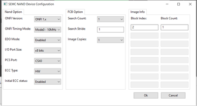

I got a problem when trying to configure boot device for external SEMC NAND (MT29F4G08ABADAWP) in RT1062 core. I used FlashLoader
(according to 痞子衡嵌入式:恩智浦i.MX RT1xxx系列MCU启动那些事(8)- 从Raw NAND启动)
as well as NXP MCU Boot Utility v3.5 to do that, but both failed.
In FlashLoader command line, the error is :
./blhost.exe -p COM9 -- configure-memory 0x100 0x2000
Ping responded in 1 attempt(s)
Inject command 'configure-memory'
Response status = 21218 (0x52e2) kStatus_SemcNAND_FailToUpdateDbbt
In NXP MCU Boot Utility, the error message is "MCU has entered Flashloader but failed to configure external memory" with responce "10004(0x2714) No response packet from target device."
Could you help with issue? Thanks in advance.

Can you please share SEMC NAND configuration page you set in tool with me?

Below is the screen shot in MCU Boot Utility v3.5.0:
It's strange that I tried select MCU Device to "i.MXRT1050x" instead of "i.MXRT1060x" in the BootUtility tool with the same Boot device configuration settings, the configuration step passed:

jay_heng
It seems that we need to update RT106x flashloader file for MCUBootUtility tool/
1. Build srec file from \SDK_2_12_0_EVK-MIMXRT1060\boards\evkmimxrt1060\bootloader_examples\flashloader
2. Rename srec file to flashloader_user.srec and put it into \MCUBootUtility\src\targets\MIMXRT1062\
2,769 Views

BlackTurbo
Turns out that with Flashloader v2.1 from the Flashloader RT106x release package, configure-memory command will give "kStatus_SemcNAND_FailToUpdateFcb" error, and if using Flashloader v2.8 from the SDK 2.10, the configure-memory command will give "Unkown error code" error.
Both of them can't work but give different error for the same configuration params.
Then which version should be the right one to do the configuration for RAW NAND boot?
2,658 Views
jay_heng
I have ever verified Raw NAND boot on RT1170-EVK board with MCUBootUtility v2.2, you may use the flashloader file under MCUBootUtility v2.2
