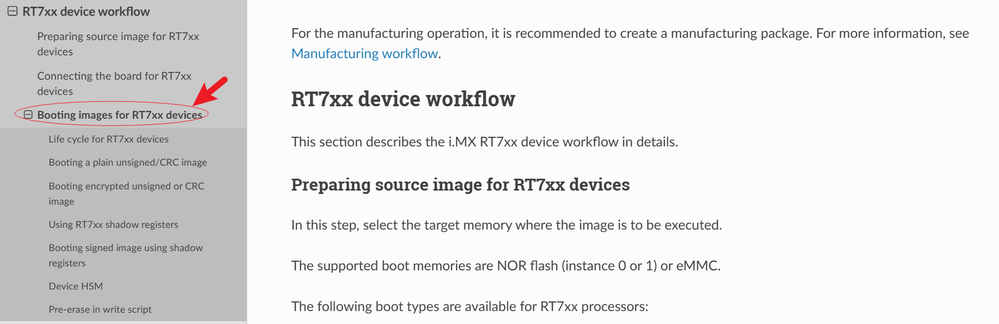

A3: Signing tools for RT700 secure boot
For signing RT700 images, the recommended tool is:
MCUXpresso Secure Provisioning (SEC) Tool
This tool provides GUI workflow, and Full command-line interface , Support for image signing, certificate handling...
For more detail information, you can refer to the below link.
MCUXpresso Secure Provisioning Tool Documentation
https://docs.mcuxpresso.nxp.com/secure/latest/06_processor_specific_workflow.html#id13  Snipaste_2026-02-27_18-00-24.png
