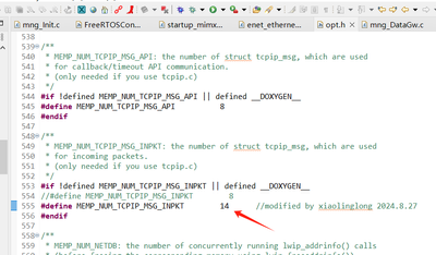

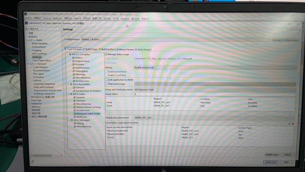

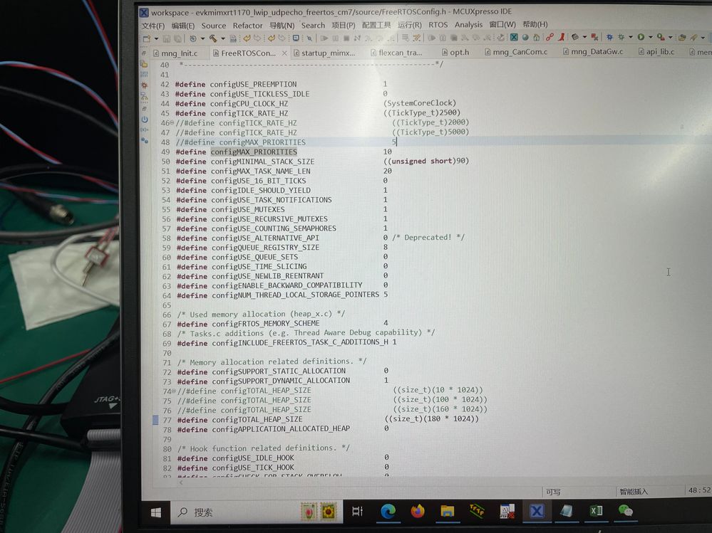

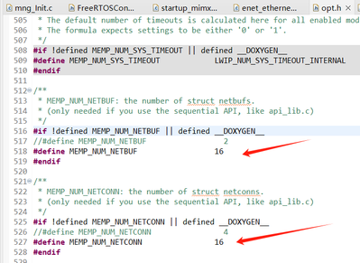

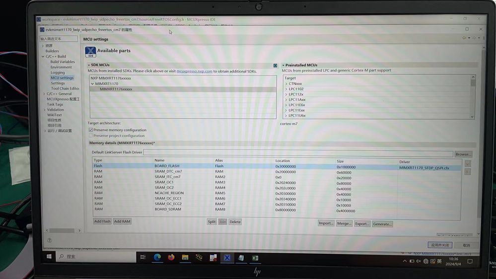

i.MX-RT1170 Hello everybody,
After modifying the memory configuration of RT1176, I encountered a mempma11oc: out of memory in poo1 NETBUF error. I spent two months without finding the problem, please help me find the reason, thank you

I looked up key information about this example you provided and It seems not from NXP offical examples, below coments for your reference to debug, hopt it help you find the root cause.
1. Enlarge MEMP_NUM_NETBUF
// Depends on your runtime enviroment
if (memp_free(MEMP_NETBUF) < 10) {  // 当剩余内存少于10个时
    PRINTF("Increasing NETBUF pool size\n");
    memp_increase(MEMP_NETBUF, 10);  // 增加10个
