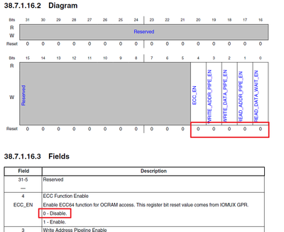

Is the RT1176 FlexRAM ECC enabled by default, or does the user need to intentionally enable it with a set of preload configuration commands? We're using the MiMXRT1170 - EVKB.
We observed this line of code, but unsure what exactly this means. Thanks in advance for any assistance.

Hi @Mike_Z ,
Question:
Answer:
The RT1176 FlexRAM ECC disabled by default, The user need to intentionally enable it.
Please refer to MIMXRT1170RM chapter 38.7.1.16 OCRAM Pipeline And ECC Enable (PIPE_ECC_EN)
I suggest you can refer to SDK demo "evkbmimxrt1170_mecc_single_error_cm7"
