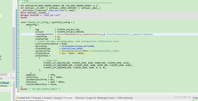

    One point need to care, which is ignore previously, it is the flexSPI speed, please use the low speed test it, as the FlexSPI2 NOR secondary pin group doesn't offer DQS pad, so only support low-speed read.
So, please modify the code XIP:
1. app XIP
.seralClkFreq use 30Mhz, just for testing.
DQS loopback internally.

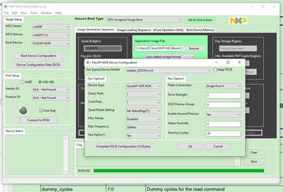

2. MCUbootUtility, please use this configuration to test:
3. Polling code

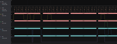

I'm actual in lab and had a close look at the QSPI signals. I can see MCU reading SFDP registers on normal SPI mode with 30MHz clock. Afterwards the status register 2 is read (also with 30MHz normal SPI), chip has onle the quad enabled flag 0x02 set. Up to this point all seems fine.
In the next step an XIP read array command (0xEB) is startet at address 0x001000. So MCU read IVT Table. This access is done with 60MHz as expected cos I've burned 'xSPI_FLASH_FREQ' fuses to value '6'. Strange thing here's that I can see data from flash after 8 dummy cycles but data will start with address 0x001004. According Adesto datasheet the flash has default 2 dummy cycles, so probably the chip sends first 4 bytes while MCU sends dummy cycles.
As you can see in below screenshots the data lines show 0xCD 24 00 as first data.
I've set the autoprobe fuse but propably the autoprobe failes due to slow SPI clock. I've try to set dummy cycles fix to 2 in fuses xSPI_FLASH_DUMMY_CYCLE to see if it helps, otherwise I start with next PCB on monday.
Best Regards

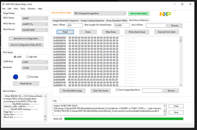

I've tested the MCU Boot Utility with your settings, but without success. On Logic Analzyser I can see an Read Array command but with starting address 0x001000. The Flash response with data (but here I assume with 1 dummy cylce to mouch, data starts with 0x10 02 but should start with 0xD1 00 20). As you can see in screenshots below there is more or less valid data in QSPI lanes but in data showed in MCU Boot Utility has nothing in common.
I'll go on with changes in polling example.
Best Regards

   Dummy cycle is really didn't modified, I find your QSPI flash dummy cycle is 2, and in the FCB, the dummy cycle should be filled with:
FLASH_DUMMY_CYCLES-2
So, do you try to input the dummy cyle in the code or the MCUbootUtlity as 0, whether the wave output the correct dummy cycle or not?
  I find your MCUBootUtility already can read the data, just the readout data is not correct.
Kerry

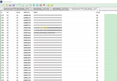

We've done some research and it looks like a problem with our flash. We've attach a QSPI Nor Flash at FlexSPI2 (using secondary pin group). After I changed the boot config to serial loader I can access using debugger.
But now I ran into next issues. After serial loader was active I changed fuse bits with MCU Boot Utility, I changed fuses 0x9A0 to 0x00000006 (set FLASH_CONNECTION_SEL to 'PORTB CS0' and FLEXSPI_SPI_GROUP_SEL to 'secondary'). After reboot of device I still can access via JTAG but there is no connection with MCU Boot Utility anymore.

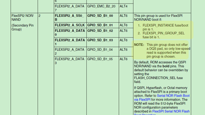

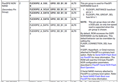

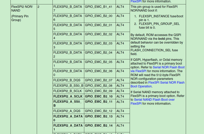

according Lauterbach support it should be possible to access QSPI flash at FlexSPI2.
Wr're using 2nd pin group, so correct tabel from TRM should be:
Actual I use a new hardware. Boot mode is set to 'Internal' and no fuses are burned.MCU start to 'Serial Download', I can connect using 'MCU Boot Utility'.
I've managed to change polling transfer example. Debug output shows "FLEXSPI example started!" and "Vendor ID: 0x1" (I think the AT25FF161A has vendor ID 0x1F). Call to function flexspi_nor_enable_quad_mode() won't return. I think there's still no connection to flash.
When I got it right there is no need to change fuse for 2nd pin group to this test, let me know if I had to.

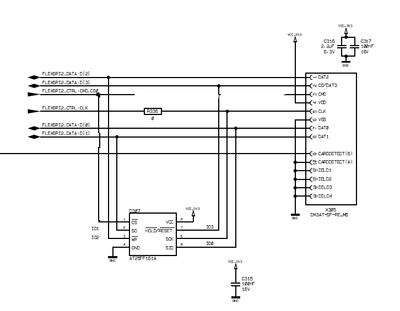

Stephan_
I try to answer your questions as good as possible
1 - We're using Adesto AT25FF161A which is quite simmilar to the AS25SF series.
2 - According Lauterbach Support the flash connection should working, but I'm on to clarify this in parallel.
3 - Here are the schematic part with flash connection. The CS wire is changed to CS0 on my board, actual PCB accidentally connected flash to CS1.
4 - I've added new pins in 'pin configuration' from MCUXpresso. Added used peripherals and updated code with MCUXpresso. Changed definitions EXAMPLE_FLEXSPI, XAMPLE_FLEXSPI_AMBA_BASE, EXAMPLE_FLEXSPI_CLOCK, FLASH_PORT to FlexSPI2. Changed configuration to run from RAM. Generated AXF file is loaded with Lauterbach Debugger. I've added modified project so you can diff it.
I hope this information helps to analyze the problem. If you need further information just let me know.

kerryzhou
Hi @Stephan_
  Seems you didn't modify the LUT, please modify the LUT like this:

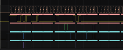

Stephan_
I've tried with your modifications but still same behavior, output "Vendor ID: 0x1" which is not correct and program stuck in function call "flexspi_nor_enable_quad_mode(EXAMPLE_FLEXSPI);".
I've PCB with attach logic analyzer on QSPI lanes but I can't see any operation on the lines. It seems like the programm dosen't access the SPI flash in any way.

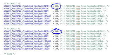

Can you have a look at "flexspi_clock_init()", I'm not sure with the call to "CLOCK_SetRootClockMux()".
Best Regards
Stephan

kerryzhou
Hi  @Stephan_ ,
  Thanks for your information.
  If your flexSPI2 even don't have the wave, it means, the code still not work, still need to check the flexSPI detail modification, maybe something is lost.
  About CLOCK_SetRootClockMux(), please check the details, whether it configure the flexSPI2 clock, at least the flexspi2 should have clock out.
Kerry

Stephan_
I've checked the clock MUX values, but according given documentation the value should be right:
Meanwhile Lauterbach Support was able to get flash working with uTrace Debugger. I've done some short tests and it seems to be working, so it looks like the problem is not located on PCB. I think there is still some modification missing in example project, but have no glue where...

    1. About the flexspi2 clock configuration, you are correct:
static inline void flexspi_clock_init(void)
/*Clock setting for flexspi1*/
CLOCK_SetRootClockDiv(kCLOCK_Root_Flexspi1, 2);
CLOCK_SetRootClockMux(kCLOCK_Root_Flexspi1, 0);
/*Clock setting for flexspi2*/
CLOCK_SetRootClockDiv(kCLOCK_Root_Flexspi2, 2);
CLOCK_SetRootClockMux(kCLOCK_Root_Flexspi2, 0);
/* Configure FLEXSPI2 using OSC_RC_48M_DIV2 */
rootCfg.mux = kCLOCK_FLEXSPI2_ClockRoot_MuxOscRc48MDiv2;
rootCfg.div = 1;
CLOCK_SetRootClock(kCLOCK_Root_Flexspi2, &rootCfg);
The API will help to configure the flexSPI2.

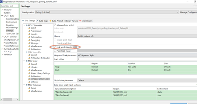

When you test the polling code, you run it in RAM?

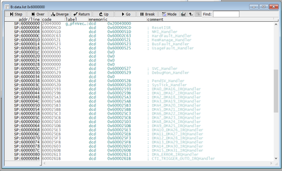

2. Lauterbach Support was able to get flash working with uTrace Debugger
 Please give me some debug screenshot, whether the flash address is correct? I mean, whether your code is downloaded to the external flash or not?
 If it can download code to the flash, whether boot works or not after you modify the fuse:

Stephan_
my test programm is running in RAM, I've use the setting you described in screenshot.
According the flashed code, when try to run from flash I use 'release' configuration in MCUXpresso. With Lauterbach I load axf file which write program code to flash. When I dump the first addresses from flash it look like this:

We're using 2nd pin group, so there is FLEXSPI_PIN_GROUP_SEL set to 1.
I've opened another thread about generation bootable binary file (Create bootable image for RT1173 QSPI flash - NXP Community), so I think we can stick to 'run from RAM' configuration and try to get polling example working.

 1.  Seems your Lauterbach already enter the debug mode, please run it directly.
   Then check the printf information, whether the external QSPI flash runs OK or not?
   You can see the printf information through the UART interface.

   2. MCUBootUtlity, seems you also connect to the chip, please select bootDevice Memory
In the Boot Device Memory, you can readout the memory.
In the connection area, you can select One Step to connect your board.
Kerry

as already stated in comment above I'm able to run the modified polling example and get some output on debug port but with wrong manufaturer ID and program stuck at "flexspi_nor_enable_quad_mode(EXAMPLE_FLEXSPI);".
MCU Boot Utility can connect to MCU but is not capable to access QSPI Flash at FlexSPI2 (2nd pin group). I'm already in contact with NXP FAE but there is still no solution.
Best Regards
Stephan

  Now, seems only your debugger Lauterbach can download the code, but I find your downloaded code is not correct, it didn't contains the FCB, IVT, so the image is totally wrong, could you please use my attached led_blinky and test it with your Lauterbach?
   My image is correct:

i've tried your blinky AXF. Unfortunately I've no access to pin M13 on my board, I've an LED on R10, but not yet managed to get an blinky work with this pin.
Nethertheless, when I program your AXF and reboot in 'internal Boot' configuration I can't access with Debugger (Core Power Down), so it seems MCU Bootloader can't load image. Also MCU Boot Utility have no access.
I've managed to get an binary image from MCU expresso with IVT and FCB. Not sure why, but after changing BOARD_FLASH from 0x3000000 to 0x6000000 in the Release linke file the following lines are missing:
/* Image Vector Table and Boot Data for booting from external flash */
.boot_hdr : ALIGN(4)
FILL(0xff)
. = 0x400 ;
__boot_hdr_start__ = ABSOLUTE(.) ;
KEEP(*(.boot_hdr.conf))
. = 0x1000 ;
__boot_hdr_ivt_loadaddr__ = ABSOLUTE(.) ;
KEEP(*(.boot_hdr.ivt))
. = 0x1020 ;
__boot_hdr_boot_data_loadaddr__ = ABSOLUTE(.) ;
KEEP(*(.boot_hdr.boot_data))
. = 0x1030 ;
__boot_hdr_dcd_loadaddr__ = ABSOLUTE(.) ;
KEEP(*(.boot_hdr.dcd_data))
__boot_hdr_end__ = ABSOLUTE(.) ;
. = 0x2000 ;
} >BOARD_FLASH
After adding manual and switch off managed linker files in project configuration I got a binary with FCB and IVT. The binary is attached, so you can have a quick look if you find an error. I got same behavior with your and mine binary file. In 'internal Boot' the MCU won't start. In 'Boot from Fuses' the MCU will go into Serial Download.
