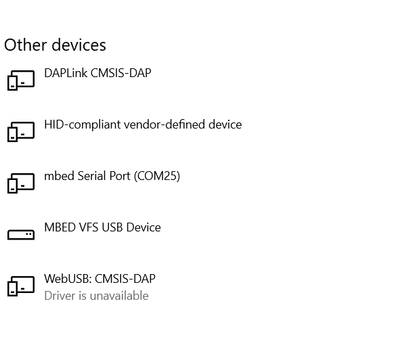

I tried with newest SDK V2.15.0 after deleted older once, but still facing same issue. But in the Device Manger I am seeing one incompatible driver issue for WebUSB: CMSIS-DAP. I tried uninstalling it and then connecting the EVK again, it got reinstall but still same error.
Please suggest what can be done in this or if you can share from where I can download this driver manually?

I am still getting this below error in the device manager:
The drivers for this device are not installed. (Code 28)
There are no compatible drivers for this device.
To find a driver for this device, click Update Driver.
Is there any way I can download this driver from somewhere?

I tried with shared driver but still having same issue. In device manager still getting that driver incompatible issue and same error in debugging as last time.

  Please check the :
Control Panel\Hardware and Sound\Devices and Printers
This is my CMSIS DAP version situation:
You can see, I don't have any issues.
Please share your related picture with me.
BTW, which PC OS you are using now?
Seems your PC can't install the CMSIS DAP successfully. Whether your PC install some firewall to prevent the CMSIS DAP to work?
