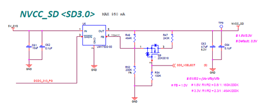

How can I set 3.3V mode or 1.8V mode for GPIO_SD?
GPIO_LPSR, AD and DISP have register for supply voltage range selection. But I couldn't find similar register for GPIO_SD and EMC.
Is the mode simply selected by the NVCC_XX power rail voltage without register setting?

Hi @Eugene3 ,
The pad work in 3.3v mode or 1.8v mode is designed by hardware. NVCC_SD is the power source of SD pin group. You can refer to RT1170 EVK schematic for how to switch.

Can I also apply same way to other power rails to set 1.8V/3.3V mode?
ex. If I use 1.8V power to NVCC_EMC1, will GPIO_EMC_B1_XX work in 1.8V range?
2,783 Views
jingpan
Hi @Eugene3 ,
Yes, it can.
