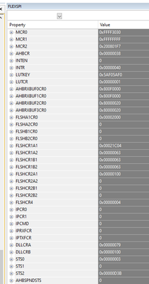

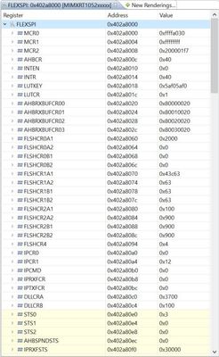

Gonna bump this as I have found the same thing.
Indeed globally disabling cache with SCB_DisableDCache() also resulted in similar, but not exactly the same behaviour. Basically as described above I'd see memory management faults here there and everywhere. It'll work for a short time, but eventually except somewhere.
I wonder if it could because with cache on, all transactions would be aligned? But with cache off we get a bunch of ad-hoc transactions?
I'm doing this to test the memory, as we've been finding the very occasional crash on some devices where we see corrupt data.

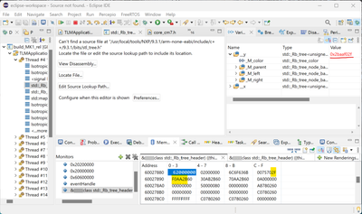

This is very curious:
Misaligned read, it would seem, causing an exception.
It's also repeatable.

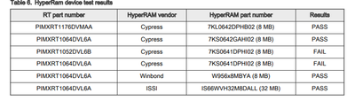

In AN12239 (https://www.nxp.com/docs/en/nxp/application-notes/AN12239.pdf), there is a list of validated HyperRAM devices:
I see that the 7KS0641DPHI02 is listed as FAIL ! This is the part I use, and as I understand it, also the part suggested in the schematics for the 1064 EVK:

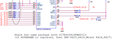

Because of that, I assembled another prototype with the S27KS0642GABHV020 (https://www.cypress.com/file/498611/download) instead.
For some reason (could be the assembly of the prototype) the HyperRAM is not working at all (garbage read from it). Just to be sure, can you confirm that the S27KS0642GABHV020 will be able to use the same LUT, setup etc, as the 7KS0641DPHI02  ?
I see the 0641 is listed as "HyperRAM 1.0" and the 0642 is listed as "HyperRAM 2.0"

Now, I dont know if the 0642 versus the 0641 device could have anything at all to say regarding my non-cache issue I see (I doubt it very much), but I thought that I would investigate....
334,692 次查看
victorjimenez
Hello Carsten,
The reason why we mention that with the 7KS0641 the test failed is related to some issues with chip select timing on Gen1 Cypress HyperRAM. The issue has been fixed in their Gen 2 devices. In the part numbers, the digit after the density reflects the device technology generation. So 7KS0641 devices have the problem, but 7KS0642 devices do not. So as far as I can tell, you shouldn't have any problems migrating from one HyperRAM to another. However, it would be better if you contact directly the manufacturer. They will have more information regarding the implications of one memory being HyperRAM 1.0 and the other 2.0.
I'm still investigating internally with the apps team the implications of having the non_cacheble section at the HyperRAM. I will give you an update as soon as possible.
Victor

The reason I found this problem in the first place is because I have made several testboards for RT1064, one with SDRAM and one with HyperRAM (also doing SDRAM testing on LPC54628). On these, I run different tests, one of them is Dhrystone, this is to get an idea of the penalty running code/data in the different sections/types of memory for coming projects.
Now, I mentioned that the 7KS0641 was suggested on the EVK schematics (hence I used that in my design), and in the AN it was mentioned that the '0641 would fail. I used the '0642 instead, and that would not run (at least with the same parameters as the '0641 did).

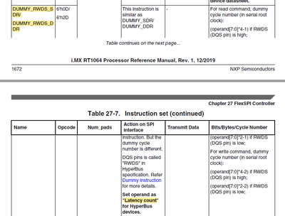

Then I looked in the application note "Migrating from S27KL0641/S27KS0641 to S27KL0642/S27KS0642" from Cypress:
https://www.cypress.com/file/498626/download
There they mention one "critical difference", that is the "Default latency" which is 6 for the '0641 and 7 for the '0642. I found that this latency is set in the LUT for each command:
So I changed the LUT:

I tried to capture the FlexSPI1 registers right after the (bus) fault:
