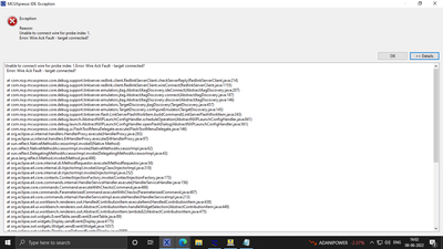

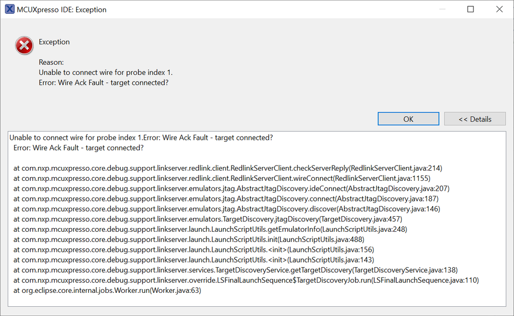

Hi, just started working with MiMXRt1064 -EVK, and today it suddenly stopped debugging and coming up with this error message, I am using on-board Link Server bugger and MCUXpresso with version as below
MCUXpresso IDE v11.1.1 [Build 3241] [2020-03-02]
(c) Copyright 2006-2020 NXP
OS: Windows 10, v.10.0, x86_64 / win32
Java version: 1.8.0_201
Anyone can help please?
Thanks!

victorjimenez
Hi Ping,
As we discussed in the case, it seems that your RT is bricked and none of the methods that we discussed work to recover your board. With the things that you were working, it seems not possible to brick your board so the best way to continue with this is to submit a warranty ticket: Returns and Warranty Information | NXP

769985518
使用Jlink将片内flash擦除掉即可
