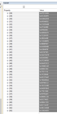

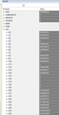

carstengroen
Senior Contributor II
Thanks Victor,
one thing that crossed my mind....
In AN12239 (https://www.nxp.com/docs/en/nxp/application-notes/AN12239.pdf), there is a list of validated HyperRAM devices:
I see that the 7KS0641DPHI02 is listed as FAIL ! This is the part I use, and as I understand it, also the part suggested in the schematics for the 1064 EVK:
Because of that, I assembled another prototype with the S27KS0642GABHV020 (https://www.cypress.com/file/498611/download) instead.
For some reason (could be the assembly of the prototype) the HyperRAM is not working at all (garbage read from it). Just to be sure, can you confirm that the S27KS0642GABHV020 will be able to use the same LUT, setup etc, as the 7KS0641DPHI02  ?
I see the 0641 is listed as "HyperRAM 1.0" and the 0642 is listed as "HyperRAM 2.0"
My setup is as follows:

I tried to capture the FlexSPI1 registers right after the (bus) fault:
The MPU is currently set like this:
