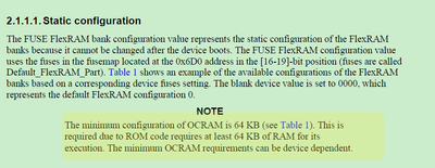

Hi @choix361 ,
  Please check the application note:
https://www.nxp.com/docs/en/application-note/AN12077.pdf
So, to keep safe, leave 64K for the ROM, thanks.

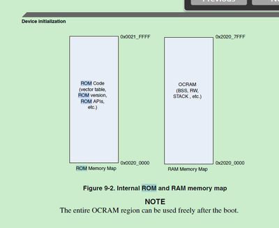

Answer: Yes, you are right, ROM use 64K OCRAM2. please check this picture from the reference manual:

Hi Kerry,
Thanks for clarification. I have one follow up question. Attachment shows OCRAM2(0x2020_0000~0x2020_7FFF) is used by Boot ROM. 0x7FFF is 32K not 64K. However, your answer was "ROM use 64K OCRAM2"?
64K should be 0xFFFF.
Code can be safely placed from 0x2020_8000? (after 32K)
or 0x2021_0000? (after 64K)
-Hyunwoo

Hi @choix361 ,
