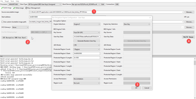

jeremyzhou
After checking, the image_enc.exe and image_generate.exe actually generate different results when inputting the same parameters, I guess it's related to the ways of parsing the key of the image_enc.exe and image_generate.exe.
In my opinion, I'd like to suggest you use the MCUXpresso Secure Provisioning tool to build an encrypted image from a raw image (as the figure shows),
1) load the raw image;
2) Configure the XIP keys;
3) Clicking the Bulid image, then the tool will generate an encrypted image.
