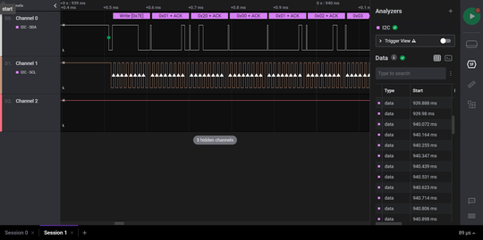

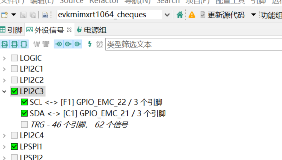

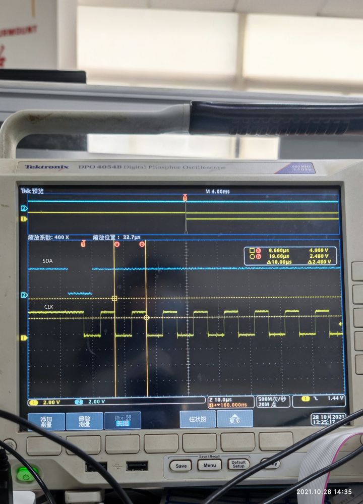

in RT1064 I wan to use LPI2C ,
i use MCUXpreso IDE and SDK use SDK_2_10_0_MIMXRT1064xxxxA
use demo evkmimxrt1064_lpi2c_polling_b2b_master
but find a problem:
LPI2C only send start singe
LPI2C send singeLPI2C send singe
pin config
pin configpin config
code :

2 返答(返信)
3,229件の閲覧回数
Omar_Anguiano
Hello
Hope you are well.
I was able to replicate running the example with SDK version(2.10.0) and the results were successful.
I suggest you check if this issue persists with LPI2C1 and the default pin configuration from the example.
If you have more questions do not hesitate to ask me.
Omar
3,256件の閲覧回数
lixuhui112
but I use the same demo in MIMXRT1060-EVK it is ok
