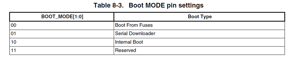

3. Is it possible boot from internal ROM.
Answer: Please check the boot mode:
4. if possible boot from internal ROM, then jump to internal flash. is it possible ?
Answer: In factor, when you boot, the ROM code will run automatically, you don't need to control it.
   You just need to download the code to the internal flash, then set the boot mode as internal boot, then the ROM will help you to boot the app from internal flash with ROM boot function automatically.

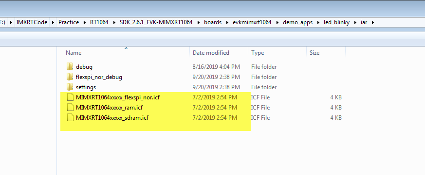

emvlabs
Thanks for your kind explain.
But I have some questions yet.
1. flexspi_nor.icf is used the external SRAM, so I try to internal RAM is it possible ?
2. Boot Mode 00 works with MfgTool. is it right ?

kerryzhou
Hi ChoonGyeong Lee,
1.flexspi_nor.icf is used the external SRAM, so I try to internal RAM is it possible ?
Answer:  If you read our SDK document Getting Started with MCUXpresso SDK for MIMXRT1064.pdf carefully in SDK_2.6.1_EVK-MIMXRT1064\docs, you will find it is not the problem.
• Debug – Compiler optimization is set to low, and debug information is generated for the executable. The linker
file is RAM linker, where text and data section is put in internal TCM.
2.
    - Set boot mode 00 or 01 ?
    - Power on the target.
    - MfgTool Start
    - MfgTool download app to internal flash.
Answer: boot mode 00 is using the fuse to boot it. Please check the RT1064 system boot chapter 8, you will find the mode0 and mode 1 difference.
When in boot mode 00, If BT_FUSE_SEL = 0, indicating that the boot device (for example, flash, SD/
MMC) was not programmed yet, the boot flow jumps directly to the Serial Downloader.
So, it will enter the serial downloader mode, you can use the mfgtool to download the app through the UART or the HID.
Wish it helps you!

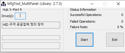

emvlabs
Dear Kerry,
Please check the sequence.
1. I use the iled_blinky project.
2. set boot mode [01] : connected MIMXRT1064- EKV
3. rename iled_blinky.out to led_blinky.bin
4. change "name in cfg.ini
    [LIST]
    name=MXRT106x-DevBootSerialFlashXiP
    ;name=MXRT1064-DevBoot
5. change name boot_image.bin to led_blink.bin.
<LIST name="MXRT106x-DevBootSerialFlashXiP" desc="Manufacturing with Flashloader">
<!-- Stage 1, load and execute Flashloader -->
<CMD state="BootStrap" type="boot" body="BootStrap" file="ivt_flashloader.bin" > Loading Flashloader. </CMD>
<CMD state="BootStrap" type="jump" onError = "ignore"> Jumping to Flashloader. </CMD>
<!-- Stage 2, Program boot image into external memory using Flashloader -->
<CMD state="Blhost" type="blhost" body="get-property 1" > Get Property 1. </CMD> <!--Used to test if flashloader runs successfully-->
<CMD state="Blhost" type="blhost" body="fill-memory 0x2000 4 0xc0000007"> Prepare Flash Configuration option </CMD>
<CMD state="Blhost" type="blhost" body="configure-memory 0x9 0x2000"> Configure QuadSPI NOR Flash </CMD>
<!-- This erase size need to be updated based on the actual boot image size-->
<CMD state="Blhost" type="blhost" timeout="30000" body="flash-erase-region 0x60000000 0x100000" > Erase 1MBytes </CMD>
<CMD state="Blhost" type="blhost" timeout="15000" body="write-memory 0x60000000 \"Profiles\\MXRT106X\\OS Firmware\\led_blink.bin\"" > Program Boot Image. </CMD>
<CMD state="Blhost" type="blhost" body="Update Completed!">Done</CMD>
</LIST>

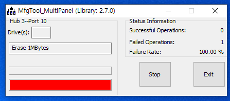

6. MfgTool Failes
The log is below.
DLL version: 2.7.0
Sunday, January 05, 2020 16:26:48 Start new logging
ModuleID[2] LevelID[10]: CMyExceptionHandler thread is running
ModuleID[2] LevelID[1]: new MxHidDeviceClass
ModuleID[2] LevelID[1]: new KBLHidDeviceClass
ModuleID[2] LevelID[10]: new MxHidDevice[011F8508]
ModuleID[2] LevelID[10]: Device Manager thread is running
ModuleID[2] LevelID[1]: Can't set m_hStopEvent before it initialized or it already stop
ModuleID[2] LevelID[10]: CmdOperation[0] device chagned and reset to state 2
ModuleID[2] LevelID[10]: ExecuteCommand--Blhost[WndIndex:0], Body is get-property 17
ModuleID[2] LevelID[10]: PortMgrDlg(0)--Path=\\.\hid#vid_15a2&pid_0073#6&2383844a&0&0000#{4d1e55b2-f16f-11cf-88cb-001111000030}
ModuleID[2] LevelID[10]: Get Property 17(Secure State) [WndIndex:0] {
"command" : "get-property",
"response" : [ 0 ],
"status" : {
"description" : "0 (0x0) Success.",
"value" : 0
ModuleID[2] LevelID[10]: Secure State = UNSECURE
ModuleID[2] LevelID[10]: Get Property 1. [WndIndex:0] {
"response" : [ 1258422528 ],
"status" : {
"value" : 0
ModuleID[2] LevelID[10]: ExecuteCommand--Blhost[WndIndex:0], Body is fill-memory 0x2000 4 0xc0000007
ModuleID[2] LevelID[10]: Prepare Flash Configuration option [WndIndex:0] {
"command" : "fill-memory",
"response" : [],
"status" : {
"value" : 0
ModuleID[2] LevelID[10]: ExecuteCommand--Blhost[WndIndex:0], Body is configure-memory 0x9 0x2000
ModuleID[2] LevelID[10]: Configure QuadSPI NOR Flash [WndIndex:0] {
"command" : "configure-memory",
"response" : [],
"status" : {
"value" : 0
ModuleID[2] LevelID[10]: ExecuteCommand--Blhost[WndIndex:0], Body is flash-erase-region 0x60000000 0x100000
ModuleID[2] LevelID[1]: Erase 1MBytes [WndIndex:0] {
"command" : "flash-erase-region",
"response" : [],
"status" : {
"description" : "10200 (0x27D8) kStatusMemoryRangeInvalid",
"value" : 10200
ModuleID[2] LevelID[10]: CmdOperation[0], current command executed failed, so SetEvent(hDevCanDeleteEvent)

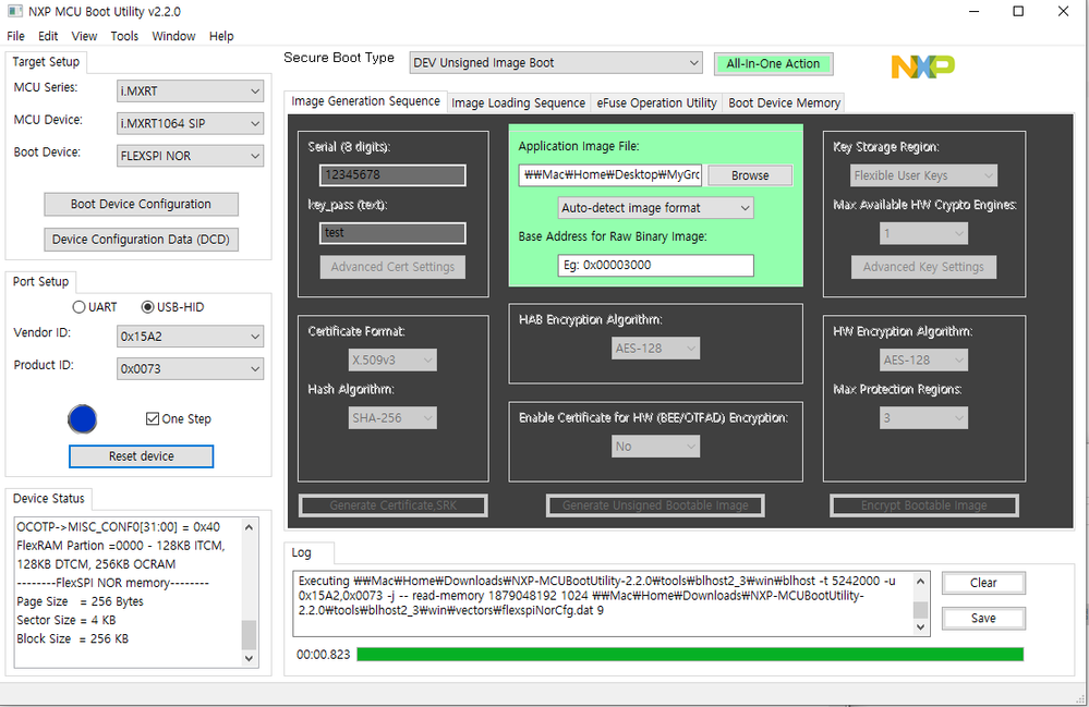

kerryzhou
Hi ChoonGyeong Lee,
    Do you want to download the code to the board, and you meet the problems, right?

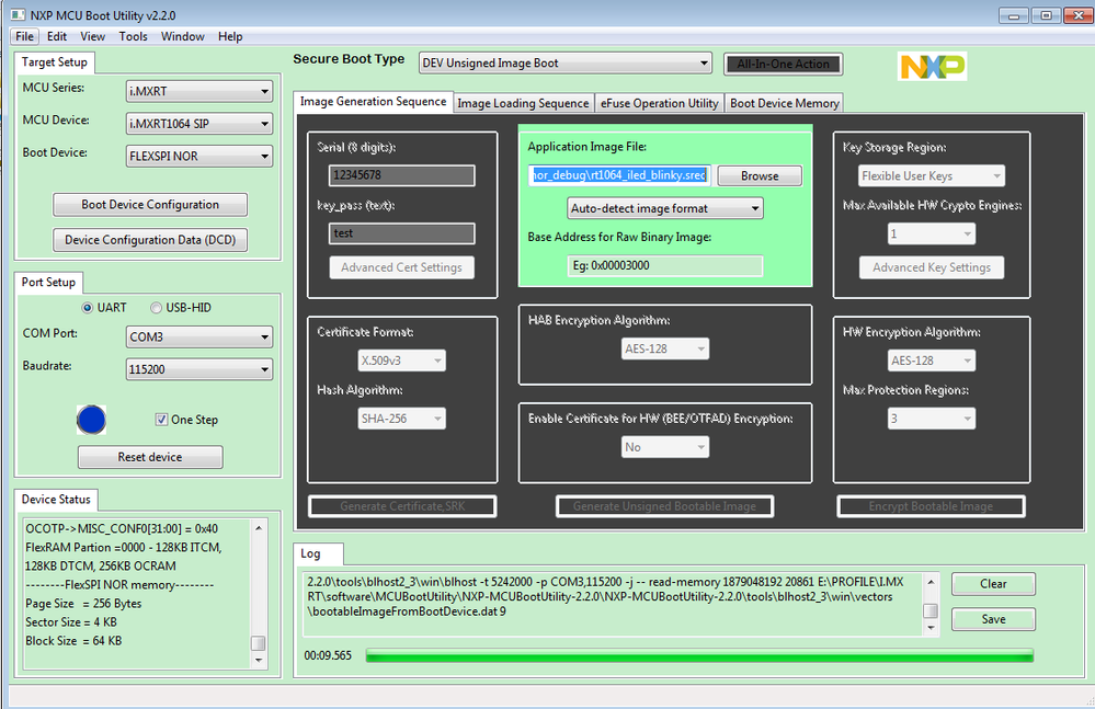

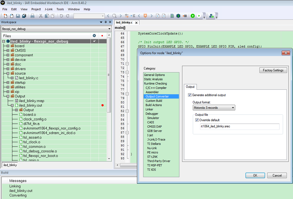

Now, two ways for you to download the code, just take SDK  iled_blinky project as an example.
1. generate the app.srec file
After you build the project, you will find the rt1064_iled_blinky.srec under folder:
 SDK_2.6.1_EVK-MIMXRT1064\boards\evkmimxrt1064\demo_apps\led_blinky\iar\flexspi_nor_debug
2. Use MCUBootUtility to download the app code
https://github.com/JayHeng/NXP-MCUBootUtility/archive/v2.2.0.zip
the related user manual is:
You can let your board enter the serial download mode, then use the mcubootutility tool to download the code.
3. MFGtool download
   You can refer to this application note, generate the .sb file to download it.
  Please refer to application note: AN12108.
https://www.nxp.com/docs/en/application-note/AN12108.pdf
 It has the detail steps.
In my own opinion, MCUbootutility is more easy to use.
Please try it again.
If you still have questions, please kindly let me know.
Wish it helps you!
If you still have questions about it, please kindly let me know.
Kerry

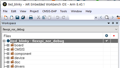

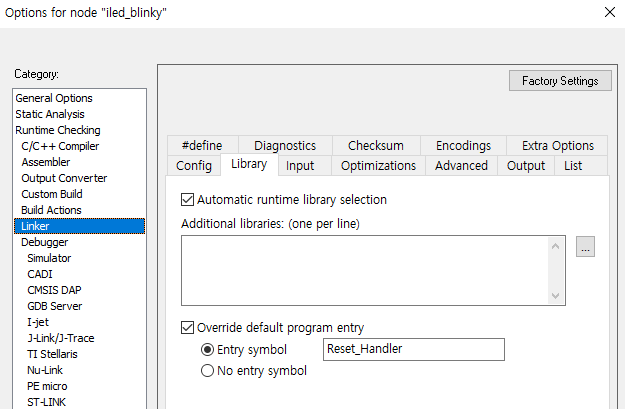

emvlabs
Dear Kerry,
Please check the build option
DEBUG
XIP_EXTERNAL_FLASH=1
XIP_BOOT_HEADER_ENABLE=0
XIP_BOOT_HEADER_DCD_ENABLE=0
CPU_MIMXRT1064DVL6A
Is it right ?
Also please check the option.
I download success, but it do not work.
I move the 7-3 switch ON.
Then reset
but no response.
What is wrong ?

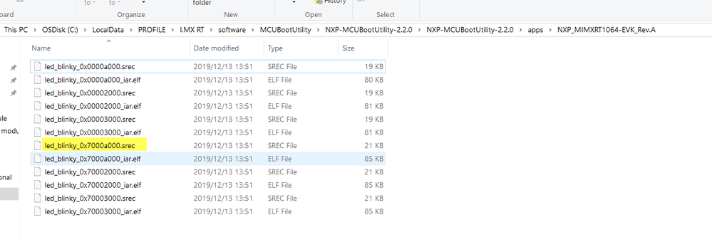

kerryzhou
Hi ChoonGyeong Lee,
    Thanks for your updated information.
    Do you try to use the offiical SDK code, for example, the very easy project, led blinky, then generate the firmware and use the MCUBootUtility tool to download it?
    Another way, you can try the MCUbootUtility tool app firmware to test it at first:
\NXP-MCUBootUtility-2.2.0\apps\NXP_MIMXRT1064-EVK_Rev.A
Kerry
8,651 Views
emvlabs
Hi Kerry,
It works,
I found that I didn't push the [All in-one Action] button before.
Now, It runs on internal flash. Is it right?
Thanks for your kind supports.
8,651 Views
kerryzhou
Hi ChoonGyeong Lee,
  Push the All in-one Action will download the APP code to the MIMXRT1064 internal Flash( in factor just put one QSPI to the chip internal side, still use the flexSPI to communicate with the QSPI flash).
  After you download it, then set the chip mode to the internal boot , then your internal flash code will run.
Wish it helps you!
Kerry
