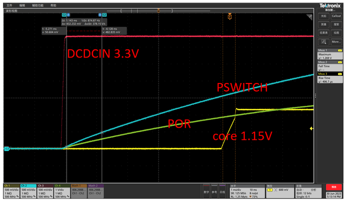

In customer's PCBA, the POR_B signal is driven with a RC reset circuit. While in RT1060 EVK, the POR_B is controled with a reset supervisor IC(UM803RS @2.63V). Below is the waveform of power sequence on customer's board. Are there any potential issues that customer should careful?

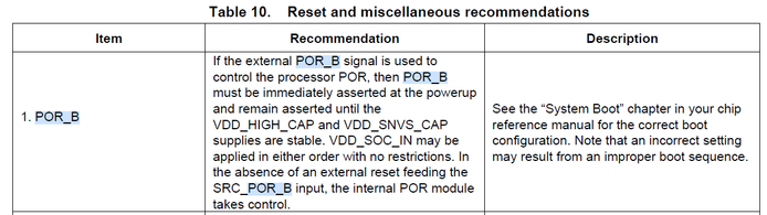

The best is to use an reset supervisor IC. See the below excerpt from AN13202
EMC Design Recommendation on i.MXRT Series
The potencial issues that I can see, with only having the RC circuit, is that you loose the power supply low voltage detection  and precise reset de-assert timing. Also, with the RC circuit, the system may be out of spec, POR_B is not actually asserted until the last supply rail reached its working voltage
The RC circuit may improve EMC performance, but it is not the recommended solution for POR_B.

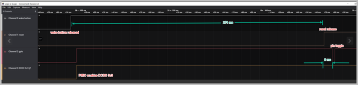

Additionally, In our EVK, the reset assert and de-assert looks like this when the during a Power on reset and SNVS wake up events. The reset is asserted with a considerable marging, more than 200 ms after the last rail booted.
