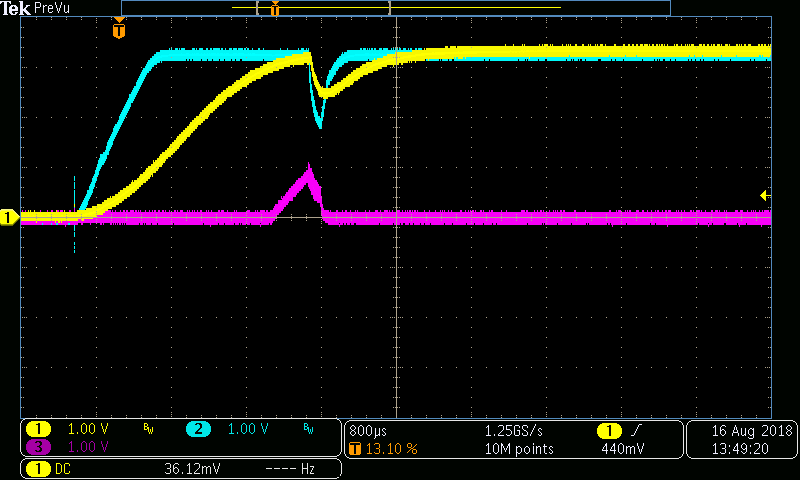

I am bring up a custom PCB and the SNVS, DCDC and 3V3 rails all come up OK in the right order. As a result I was expecting the 1V2 rail to come up to power the M7 core, but it doesn't. I have the inductor and caps connected right but nothing. Is there anything I have to do to enable it?

I've been looking at it this morning. The SNVS rail (3V3) comes up first, along with the DCDC rail (3V). I can see the DCDC start to come up (PSWITCH is high around 1ms after DCDC). The 1V2 rail (VDD_SOC_IN, aka the output from the internal DCDC) rises to around 1V then gets very noisy. At this point the DCDC rail dips and the 1V2 rail collapses.
I have had a good look through the Hardware Development Guide for the MIMXRT1050 Processor and can't see what i'm doing wrong.
The DCDC rail just goes to balls L1, L2 and K4, and the 1V2 rail coming out of the inductor / Cap filter just goes to the VDD_SOC_IN balls and the DCDC_SENSE ball (J5). I have all the required caps fitted around the RT1052.
I am using rev B silicon if that makes any difference?

martinsmith
Update: Using the Eval PCB (MIMXRT1050-EVK) I have been testing the clock and VDD_SOC_IN rail.
1. I can see that the VDD_SOC_IN comes up around 270ms before the 24 MHz xtal starts oscillating
2. If I remove J36 to stop the VDD_SOC_IN rail from coming up the 24 MHZ xtal never starts ups. I can see repeated attempts about every 270ms where it tries to start but fails.
On my PCB the XTAL never even tries to start.
So the DCDC seems to be able to interfere with the XTAL operation, even though it doesn't power it directly.

igorpadykov
one can check PMIC_ON_REQ, as described in sect.20.5.1 Turn on DCDC i.MXRT1050 RM:
To turn on the DCDC, PSWITCH and PMIC_ON_REQ must be both high
8,559 次查看
martinsmith
Yes I can see that they are both high (3.3 volts). In the screenshot below the blue trace is the VDD_HIGH, VDDA_ADC_3P3, and DCDC rails (they are all joined together, the SNVS comes up 250 ms before). The yellow trace is the PSWITCH and the purple trace is the VDD_SOC_IN (1V2 rail). PMIC_ON_REQ is connected to the enable line of the DCDC reg so comes up just before the DCDC rail.tek00000.png
8,559 次查看
igorpadykov
actually in the screenshot above the blue trace is sagging below 2V which violates power-up sequence and
voltage levels for VDD_HIGH, DCDC rails (min. about 2.8-3.0V depending on chip revision).
They should be smooth and its levels comply with Table 9. Operating ranges i.MX RT1050 Datasheet
https://www.nxp.com/docs/en/data-sheet/IMXRT1050CEC.pdf
Reason for voltages sagging may be layout errors (short circuits, broken traces), too big capacitors
(check sect.7.2. Placement of bulk and decoupling capacitors Hardware Development Guide
for the MIMXRT1050 Processor), insufficient power supply current which feeds processor.
