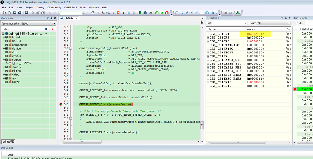

Basing code off of AN12110, I have code in place to start the CSI and am expecting some data, but despite data coming from my camera (via parallel interface) CSI seems to be dead - my code is stuck at:
while (kStatus_Success != CAMERA_RECEIVER_GetFullBuffer(&cameraReceiver, (uint32_t *) &(csiFrameBuf[i]) )) { }
Diving further in shows that:
status_t CSI_TransferGetFullBuffer(CSI_Type *base, csi_handle_t *handle, uint32_t *frameBuffer)
   uint32_t csicr1;
   /* No full frame buffer. */
   if (handle->queueUserReadIdx == handle->queueDrvWriteIdx)
   return kStatus_CSI_NoFullBuffer;
is returning because of NoFullBuffer (even tho the Logic Analyzer is showing FV, LV (HSYNC), and data pins are all providing data to the CSI Parallel pins.
I thought this issue might be similar: i.MX6 SoloX Parallel CSI Problem
But in my case - I do see the CSICR1 have the reset value of 0x40000800
BUUUT, CSI_Init from the MCUXpresso SDK doesn't seem to be overwriting that value. In fsl_csi.c, line 232, it tries to set base->CSICR1 = 0x40020912, but the debugger doesn't show any change in memory at that address (still at the reset value after single stepping over it).
 I also am not using PXP or Camera interface. Like the issue I linked to above, do I need to enable these interfaces to somehow enable the CSI to function?
Why else would the CSI not seem to activate?

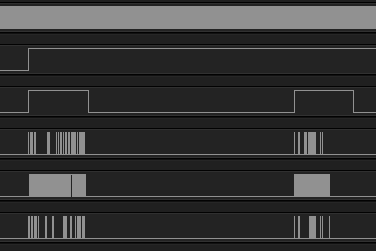

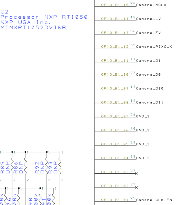

I'm using a custom board (the next revision of our board. The last board was an RT1020 custom board that used FlexIO w/ our camera chip and was working, but not fast enough for what we need, so we're on the RT1050 w/ CSI now). As such, can't run the appnote SW as-is.
As noted - I can see clock and data coming over the signals INTO the CSI pins, but that might be irrelevant as it seems that I can't even initialize the CSI? See above - writes to even set up the CSI (CSICR1) seem to be ignored?
Anyhow - here are the pin connections:
Signal Analyzer showing data coming in - you can see:
PXCLK is active (1st row),
Frame Valid goes high (2nd row),
HSYNC/LV valid (3rd row)
data OK :
