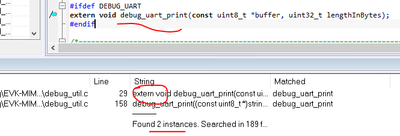

I enabled debug trace on UART1 as an option in flashloader. There's a API debug_uart_print() referenced in debug_util.c file but does NOT exist I need your help to locate it:

Hi @JamesNgo
Sorry for the late reply, I've been reviewing the issue and this is what I was able to find:
On the RT1021 flashlaoder example the body of the function is missing, however I found it on the RT1060 SDK, see image bellow.
This is from the hardware_init_MIMXRT1062.c file, I'll report this issue with my team, do you need this function or you have the inquiry where is the "body"?

Miguel04
Hi @JamesNgo
Are you refering to the body of the function or where is it declared?

JamesNgo
The "body" of the function is missing.
