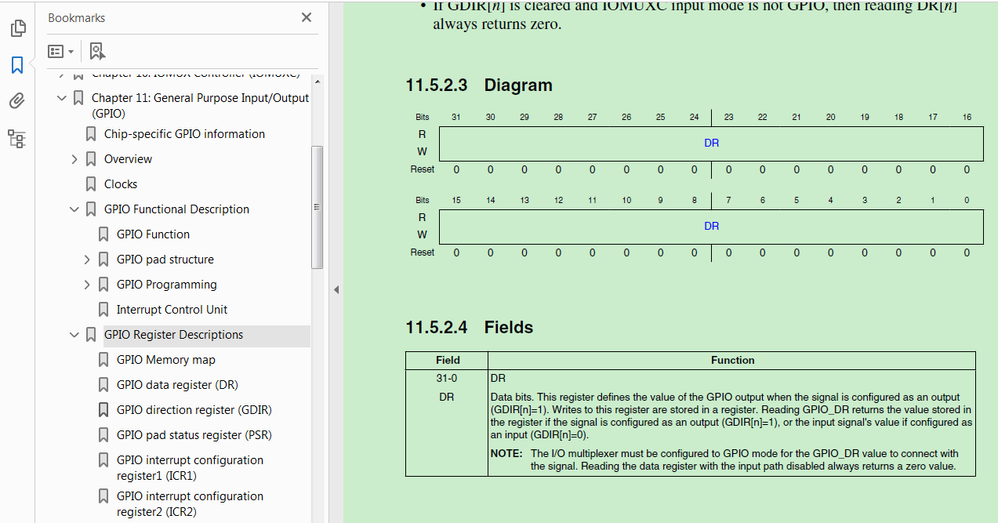

Can RT1015 write multiple GPIO at same time?
Ken
1,387 Views
kerryzhou
Hi Ken Su
  If you check the GPIO register, it is not difficult to find, you can operate upto 32 GPIOs at the same time.
Because you can find the DR register can write each bit at the same time.
With it helps you!
