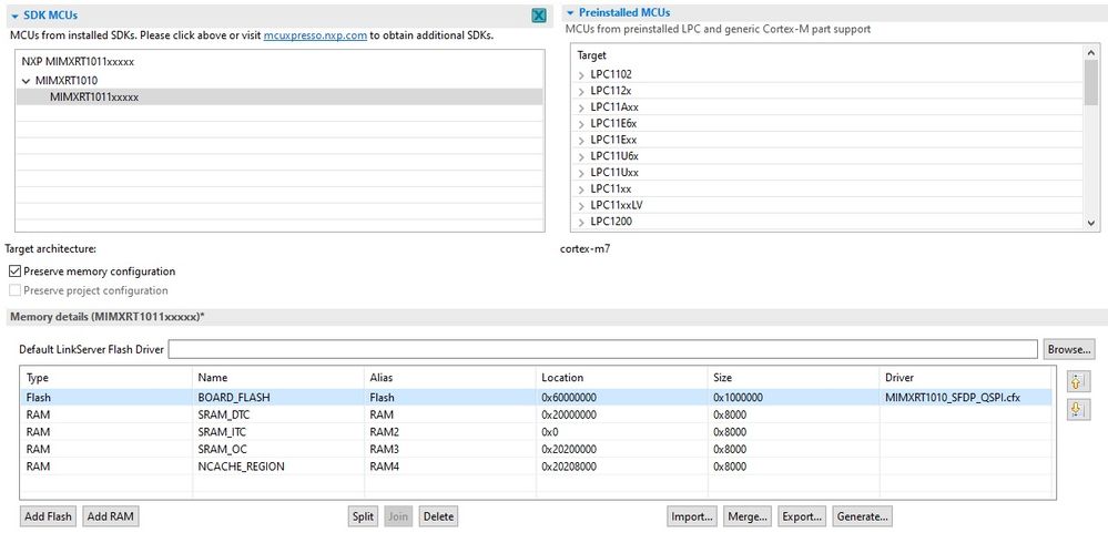

using MCUEpresso IDE v 11.2.0 with RT1010 EVK and have difficulties with flashing Flashloader demo even with Flash memory configured in MCU settings.
File 'evkmimxrt1010_flashloader.axf' load failure: Ef(11). No flash configured.
(100) Target Connection Failed
Unable to perform operation!
Command failed with exit code 1

Hello ,
Hope you are doing well.
Please try to load a regular example it looks like you may have lost connection to the target. Set the switches to serial downloader 0,0,0,1 then flash a blinky for example. Once it is working again you may set the switches back to 0,0,1,0 and try debugging your flash loader demo again. I had no problem loading the demo imported straight from the SDK without any additional modifications.
