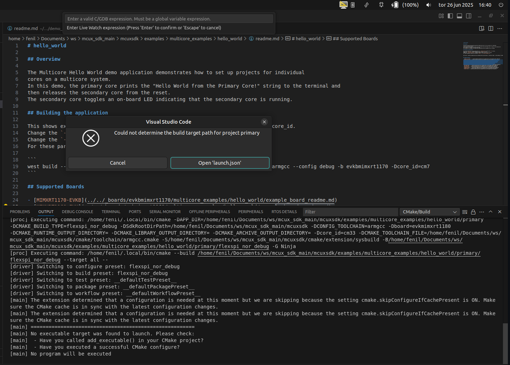

I'm sitting with the evaluation kit for the i.MX RT 1180 and I am trying to get multi-core operation working.
I have found an Application note for a similar use case for the RT 1170 (AN13264), but not for the RT1180. Is there more documentation, apart from the links above, on how to get multi-core operation working on the RT1180?
And I am trying to build and understand the Hello World multi-core example.
But I am running into trouble. Building and debugging the example project gives the following error: "Could not determine the build target path for project primary"
I have tried multiple single-core examples, and they build and execute as expected.error.pngerror.png

Hi, I have not tried the IDE. I've tried VS Code, and I have tried to build and flash using the Linux command line by following the steps from the following sources:
https://mcuxpresso.nxp.com/mcuxsdk/latest/html/gsd/run_project.html
https://mcuxpresso.nxp.com/mcuxsdk/latest/html/develop/build_system/Sysbuild.html
https://mcuxpresso.nxp.com/mcuxsdk/latest/html/examples/multicore_examples/hello_world/readme.html
Neither has worked so far. VS Code generates the error above. It imports the "primary core" project, but there is no second one as far as I can see. I'm also not sure which one to import as the "primary core" example is the only one that appears in the list.
The command-line route appears to work, as it builds and flashes without error. But after I reboot the board, nothing happens. No output over serial.
I've also tried the Multicore manager demo with the same result. Builds, flashes, but no output and no LEDs blinking.

> west build examples/multicore_examples/hello_world/primary --pristine --toolchain armgcc --config flexspi_nor_debug -b evkmimxrt1180 -Dcore_id=cm33
> west flash -r linkserver

Copied the wrong build command. This was the command I used:
west build --sysbuild examples/multicore_examples/hello_world/primary --pristine --toolchain armgcc --config flexspi_nor_release -b evkmimxrt1180 -Dcore_id=cm33

I haven't been able to replicate this issue. Does the issue occur when running with the normal "Debug" button instead of running the application via command prompt?
3,982件の閲覧回数
FNilsson
So there are two different issues.
Which one is it that you could not reproduce?
When I use the "Debug" button in VS Code, I get the error in the screenshot and when I use the command line, it goes through the entire process without error, but the application does not seem to start on the board after flashing.
In an earlier comment, you said that VS Code did not import both projects. Has that changed?

Hi @FNilsson,
I made a mistake on my earlier comment. In previous versions of the SDK, two linked projects were imported, one for the primary core and another one for the secondary core. However, from SDK 25.xx, this is no longer the case. Only one project is imported, which has two directories, one for each core. Therefore this is not the issue.
I recommend you try again, but this time importing the project as a freestanding project, and on a folder closer to C:\ drive. Sometimes issues can arise with the compiler when having a path that's too long.
3,522件の閲覧回数
FNilsson
Thanks!
I re-created the project, and it now works.
