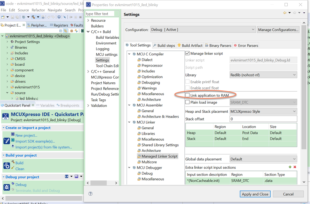

  2. If I want the program to boot from QSPI, but execute from RAM, what is the correct setting for the Preprocessor   Flags?
  Answer: just select link application to RAM is OK

 5 Is execute from RAM the default condition?
 Answer: After you generate the RAM code, then when you download the code to the QSPI flash, the ROM will copy it to the RAM, and execute the code from RAM.
