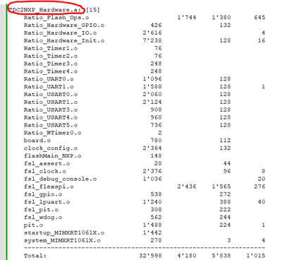

One more thing, I am using a hardware library and linking it to the application, I checked the .map file and the related files are not placed at all in the library module, is that because they were never included in the application?
These are the missed files, evkbmimxrt1060_flexspi_nor_config.o, fsl_flexspi_nor_boot.o, and dcd.o
and therefore the boot information is not included in the .srec file

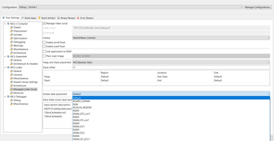

CarlosGarabito
Well, on MCUXpresso, you can modify the position where to store the data in the memory
