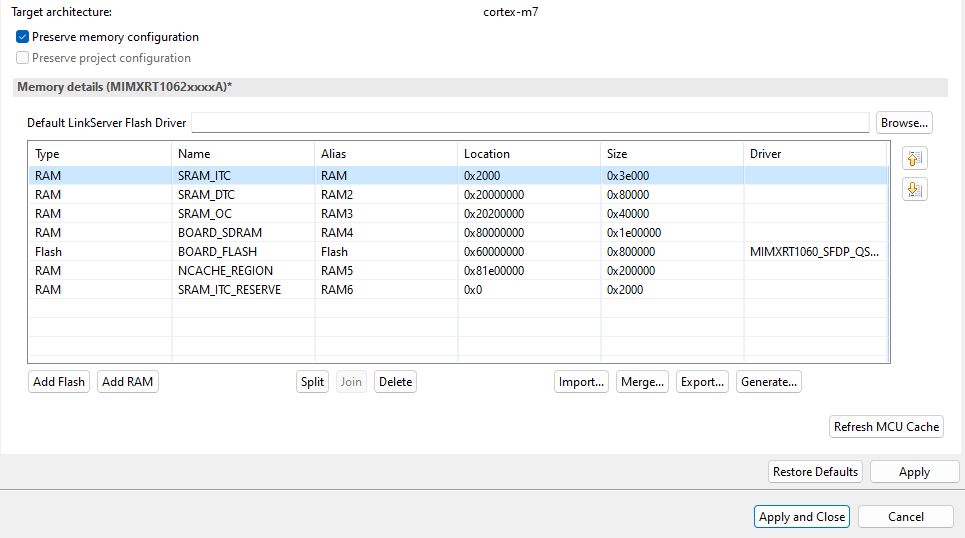

I modified the MCU settings (C/C++ Build -> MCU settings) to have the following TCM regions:
SRAM_ITC   Start at: 0x2000        Size: 0x3E000
SRAM_DTC Start at: 0x20000000 Size: 0x80000
SRAM_OC   Start at: 0x20200000 Size: 0x40000
SRAM_ITC_RESERVE Start at: 0x0  Size: 0x2000
So the sum of all of the SRAM sections is 0x100000

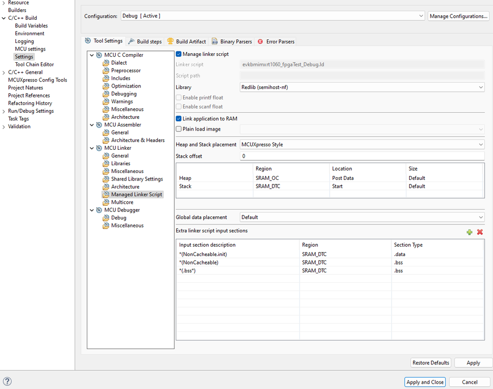

I also changed C/C++ Build -> Settings -> MCU Linker -> Managed Linker Settings
     Checked the "Link application to RAM"
     Heap in SRAM_OC Region
     Stack in SRAM_DTC Region (Location Start)
     and added an extra-linker script input section:
     *(.bss*)        SRAM_DTC

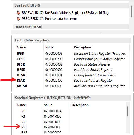

Further debugging shows that when the DTCM accesses cross over the boundary between 0x2001feff to 0x20020800  (crossing over the 0x2001ffff to 0x20020000 boundary, accesses to DTCM fail.

Further debugging shows that a fault was taken (but the code then loops)...
Here is the Memory Configuration in MCUXpresso:
MCUXpresso Memory ConfigurationMCUXpresso Memory Configuration
Here is the Linker configuration:
MCUXpresso Linker ConfigurationMCUXpresso Linker Configuration
Here is the Bus Fault report:
Bus Fault when accessing 0x20020800Bus Fault when accessing 0x20020800
It can be seen that the fault occurs when attempting to access 0x20020800.    This address should be within the range of DTCM...     It almost appears that the system thinks that DTCM is only 128K bytes in length.
My assumption is that I only need to edit these tables (Memory configuration, linker configuration, etc.) and then do a project "clean" and a project "build".    Are there other steps that I missed?
Did I configure something improperly?
