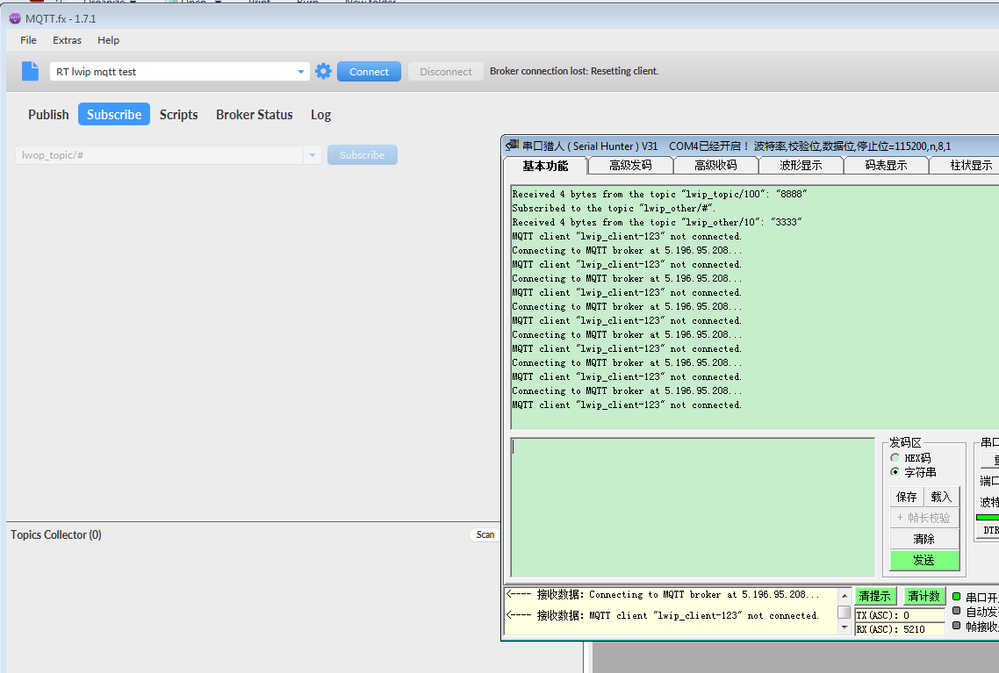

Dear all,
        I'm using IMXRT1064 development board and i want to use lwip mqtt example. So i tried an example which was given in SDK. While running the board getting DHCP IP and it resolves MQTT broker ip then subscribed a topic. But after that the connection gets failed. The serial window comes like
Initializing PHY...
 MQTT client example
Getting IP address from DHCP...
IPv4 Address     : 10.10.37.1
IPv4 Subnet mask : 255.255.0.0
IPv4 Gateway     : 10.10.0.202
Resolving "test.mosquitto.org"...
Connecting to MQTT broker at 5.196.95.208...
MQTT client "lwip_client-123" connected.
Subscribing to the topic "lwip_topic/#" with QoS 0...
Subscribing to the topic "lwip_other/#" with QoS 1...
Subscribed to the topic "lwip_topic/#".
Going to publish to the topic "lwip_topic/100"...
Subscribed to the topic "lwip_other/#".
Published to the topic "lwip_topic/100".
Received 18 bytes from the topic "lwip_topic/100": "message from board"
MQTT client "lwip_client-123" not connected.
after sending one or two messages it continuously says not connected. So whats may gives a problem. Please help me to find the solution?

kerryzhou
Hi prasanth R,
   I think it is also related to the web, or the MQTT broker side stability.
   Because, sometimes, when I can't connect the mqtt, I find even the mqtt.fx also lost the connection:
   I think, this is also the problem why the SDK author can't reproduce our problems in the previous time.
   So, maybe you also can create your own MQTT stable broker, and test it again on your side.
Kerry

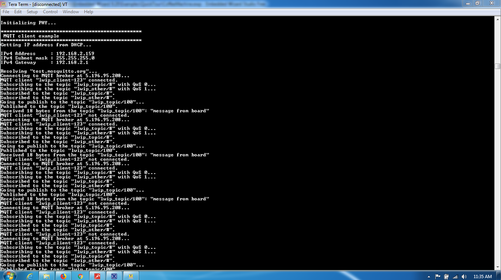

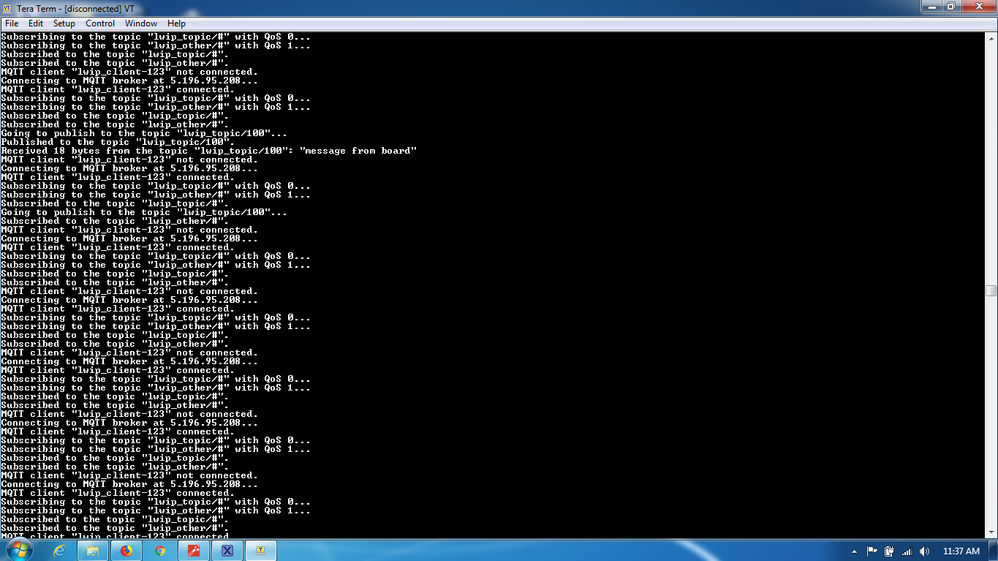

kerryzhou
Hi prasanth R,
   The download reply if used for Ari Mendes, I know you already get it.
   Today, I have finished my test platform, I test it, and reproduce your problem, it seems, it is not stable, this is my test result:
Initializing PHY...
 MQTT client example
IPv4 Address     : 192.168.43.199
IPv4 Subnet mask : 255.255.255.0
IPv4 Gateway     : 192.168.43.1

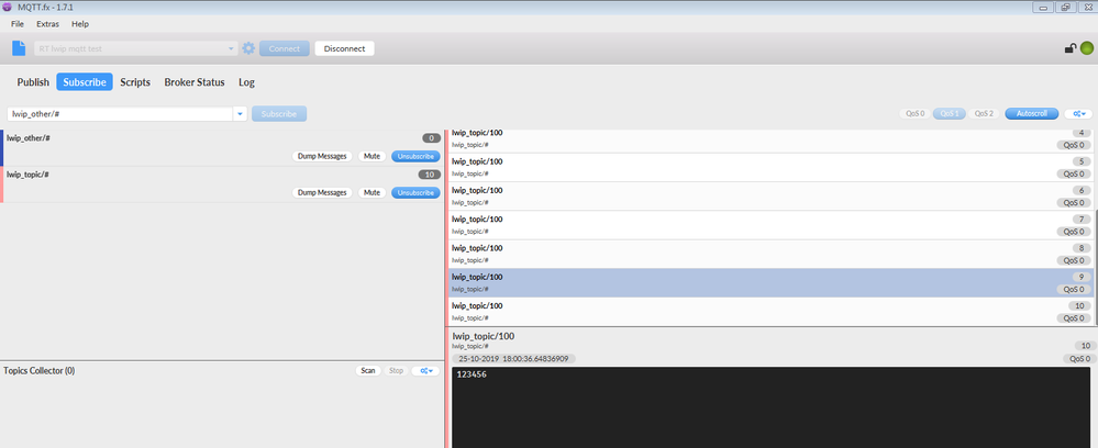

Received 6 bytes from the topic "lwip_topic/100": "123456"

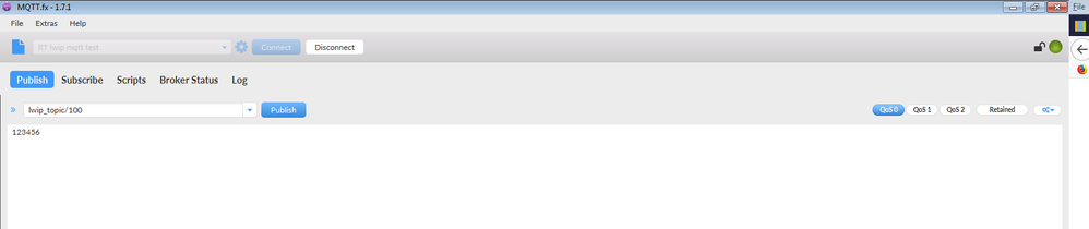

Sometimes connected, sometimes not connected, then I use the MQTT.FX to test the test.mosquitto.org, the publish and subscribe is working.
From the printf log, we also find:
Sometimes, the RT board subscribe can receive the data which is published by the mqtt.fx.
About this detail problem, I will check it with our related department, I will give more reply in the next week.
Please keep more patient, thanks.

     Today, I test it again on my side, this is my test result:
    You can find, it can publish and receive the data, but just sometimes, it disconnected:
   You can test it again, whether you can receive the data and publish the data again?
