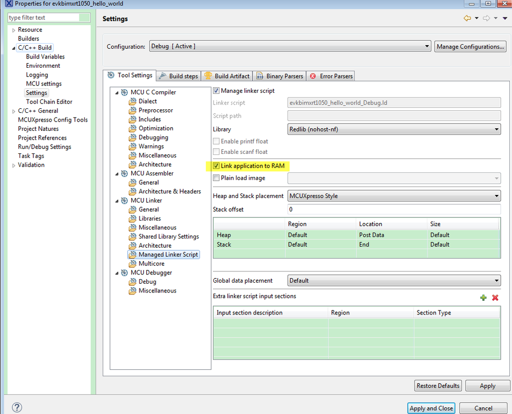

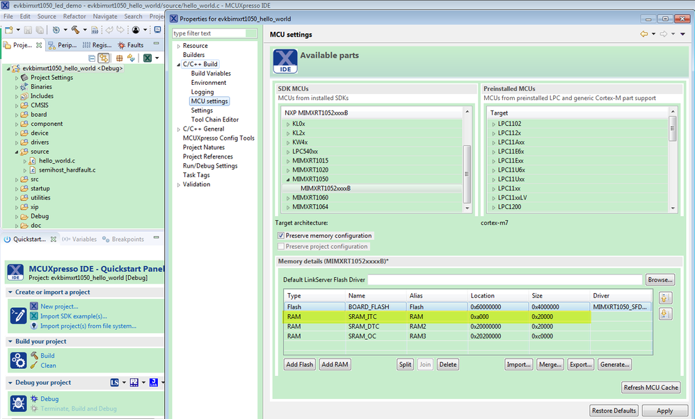

2) How do I generate an ITCM code?
 Answer:  This is very easy!
   I attach a simple code for your reference, which is based on the MCUXpresso IDE.
Then you can generate the app.srec, you can open it.
you can find, the generated code already located in the ITCM from 0XA000!
