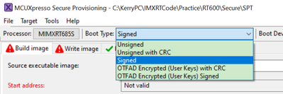

We are not using the OTFAD mode.  We are using "Encrypted + Signed" mode  which is NOT supported by the Secure Provisioning Tool, but IS supported by elftosb.exe.   We use this mode because we are using external PSRAM.

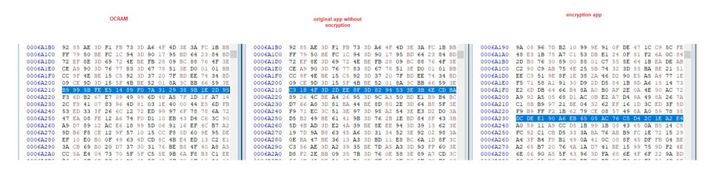

You asked for a picture of this:
In the attached, you see on the left is the exported memory from OCRAM which should be completely decrypted.  In the center is the image before encryption.  These two should match, and they match up to 0x6A210, but afterwards they do not.  On the right is the encrypted image.  Note that the OCRAM DOES NOT match the encrypted image after 0x6A210.  If the decryption was just ending prematurely, then the OCRAM should match the encrypted image after 0x6A210, but this is not the case.
Just the image has decryption issues.  The cert table and everything after are not encrypted, so no decryption is needed

I checked your picture:
Whether the code above 0x6A210,  what's the detail code now?RT685EVK.bin or extram_loader:

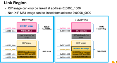

Could you please help to check, 0x6A210 is the real RAM address? When you use the internal RAM, do you use it from 0x0? or 0x00080000? I suggest you try load from 0x00080000. RT600 is the same as RT500:
Whether if you do it like this, you still have decryption issues or not?

You asked, Could you please help to check, 0x6A210 is the real RAM address?
This is not the RAM address.  The RAM address would be the 0x80000 (load address)+ 0x6A210 = 0xEA210.  In that picture I sent, the Left column shows the exported RAM from 0x80000.  So actual RAM address 0x80000 would be 0x00000 on that exported file.  It is much easier to compare to the unencrypted and encrypted file with the same offsets. Does that make sense?

  As I want to know your more detail steps, and I will also check with internal side, whether there has some limit to  none XIP encrypted+signed mode, I find the SPT tool just support signed.
